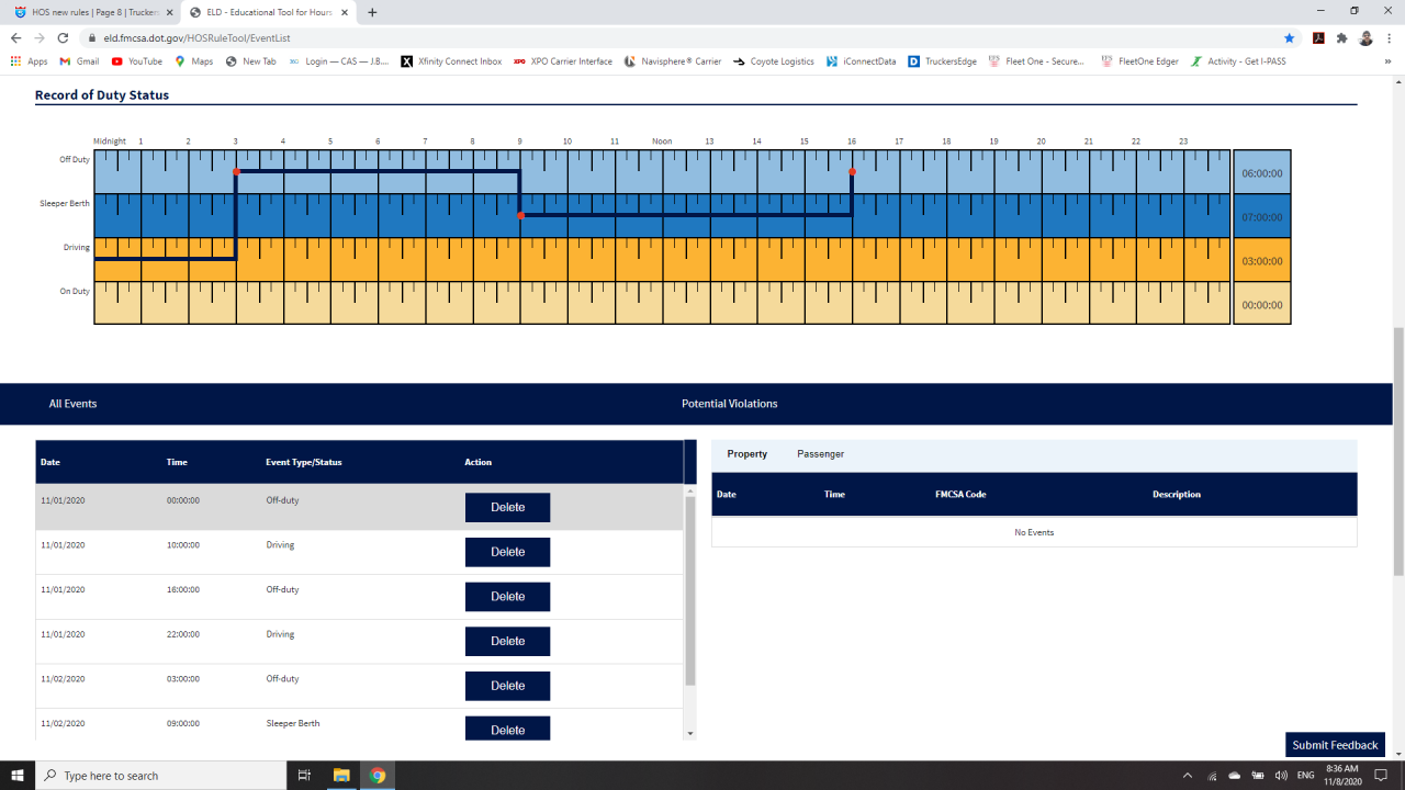

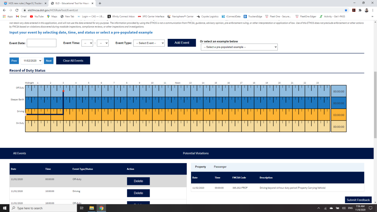

    Figure 1: Shows that the default 14 hour shift ends and midnight but the driving event continues past Midnight and creates a violation of driving beyond 14 hour shift. The 6 hours off duty are not supposed to count against the 14 hour clock, if there is intention of a split break.
    Figure1:

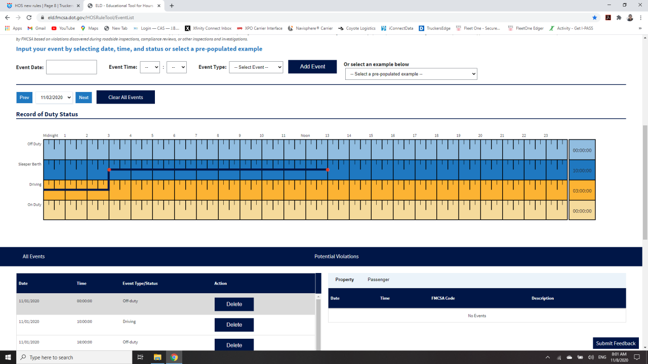

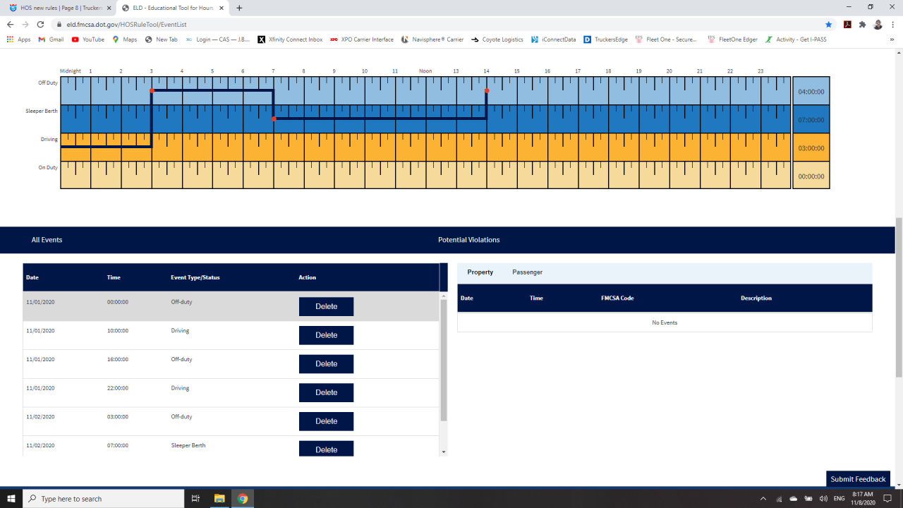

    Figure 2: shows that driving stops at 3 am (11 hour limit is up but the 14 hour shift is not if there is intention of a split break)
    Figure3:

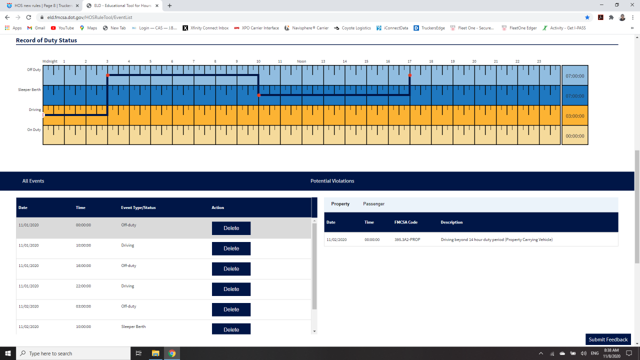

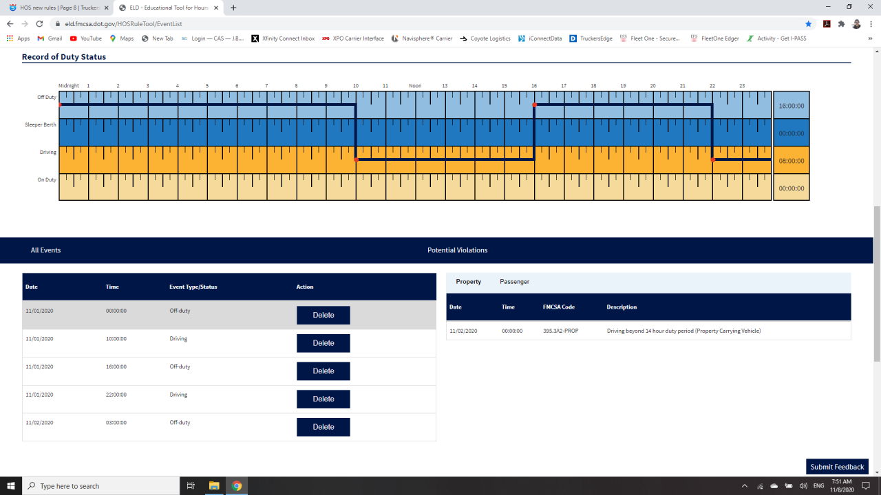

    Well, we decide to go home for 12 hours: Somehow the tool still shows the violation
    Figure 4:
    Ok let's substitute the off duty period with a sleeper break: and the violation is not shown

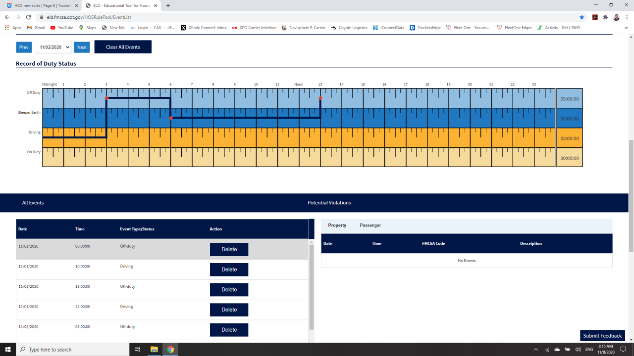

    Figure 5

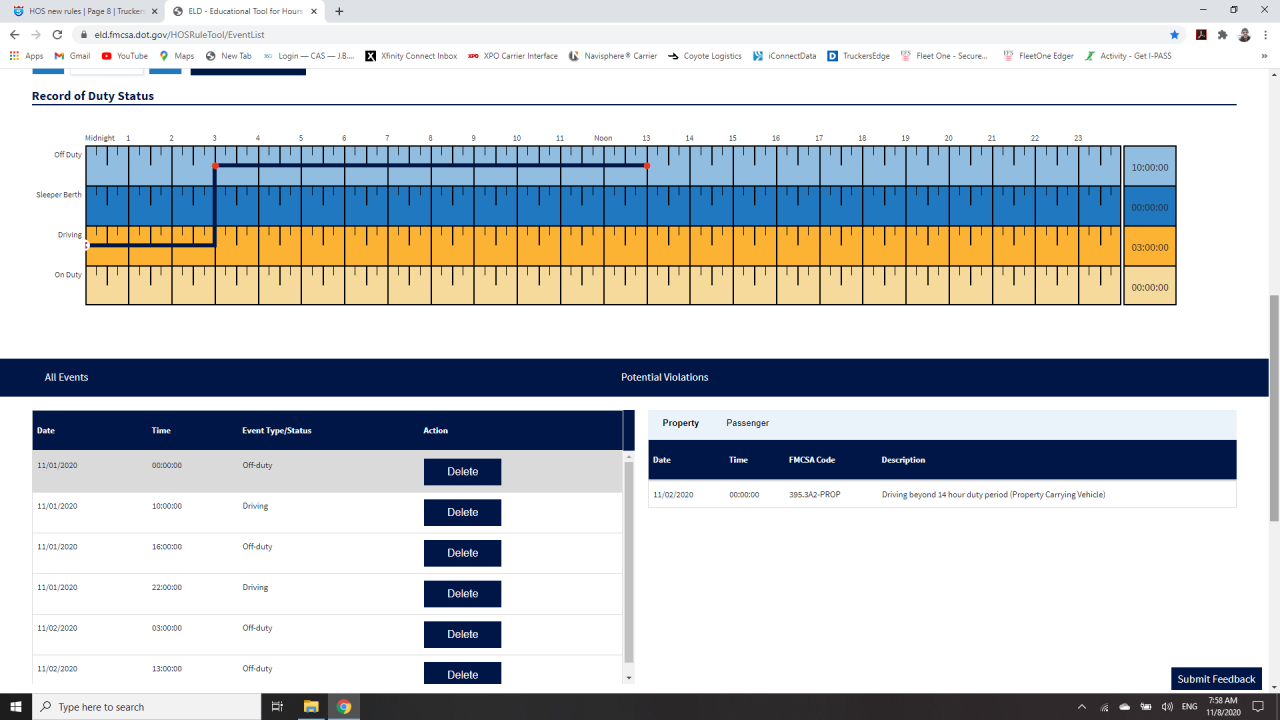

    OR something like this: which would mean that before going home we'd have to finish the 2nd break in the sleeper (7 hours)
    Figure 6
    OR no violations shown in this:
    Figure 7
    Or even this:
    Figure 8.
    Yet, for whatever reason this figure is not good and it shows violation...
    GO FIGURE....
