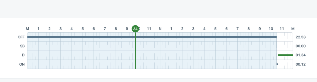

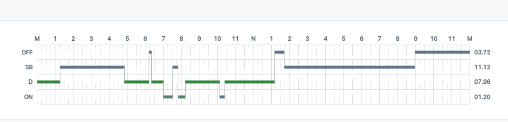

    Real life example:
    day1.
    day 2. Violation: 14 hour shift...for as long as there is No Sleeper time of 7 hours or more after finishing the day, including home arrival.
    day 2. "FIXED" No Violation...I had to go to the sleeper before going home for good.
    P.S. I can only let you guess which version I decided to choose. LOL
