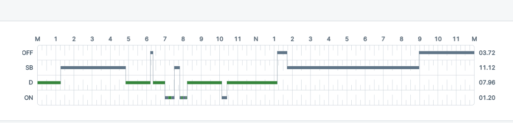

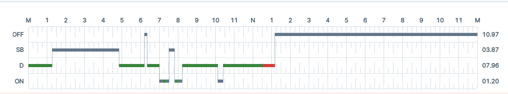

    You think? I thought so too. If you were the FMCSA director or his deputy saying this officially then I'd be delighted to hear that but nowhere did I hear anybody official confirming it.
    So, I have not choice but continue to "sleep" for 7 hours before driving home not to have those red color lines. Otherwise, I'd be a log book falsifier. It looks that my bedroom bed is less important than the mattress in my sleeper. LOL

    @ZVar I know what falsifying logbooks means so don't say that I falsified anything because I showed two versions of which only I would know what will end up filed and archived. :D I would never admit to falsify in a public forum like this, even if I did.
    I showed the phenomenon and put ELOGS infallibility to question.

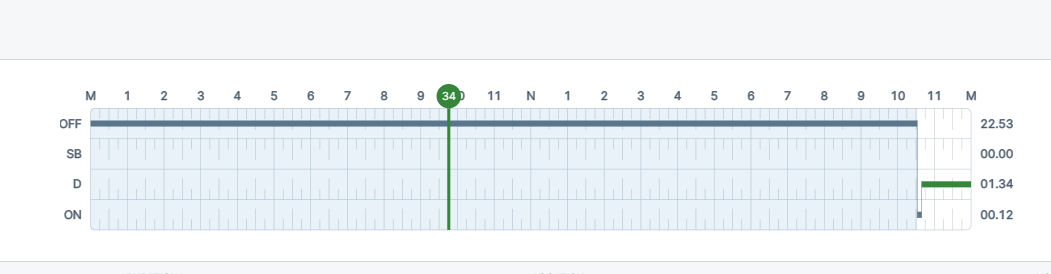

    I tested both, landed on kt because it was cleaner.
    Logs are in descending order
    According to you, im in violation if i dont hit sleeper, the app has it tracked fully correctly
