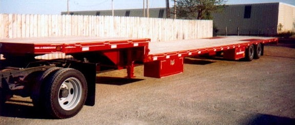

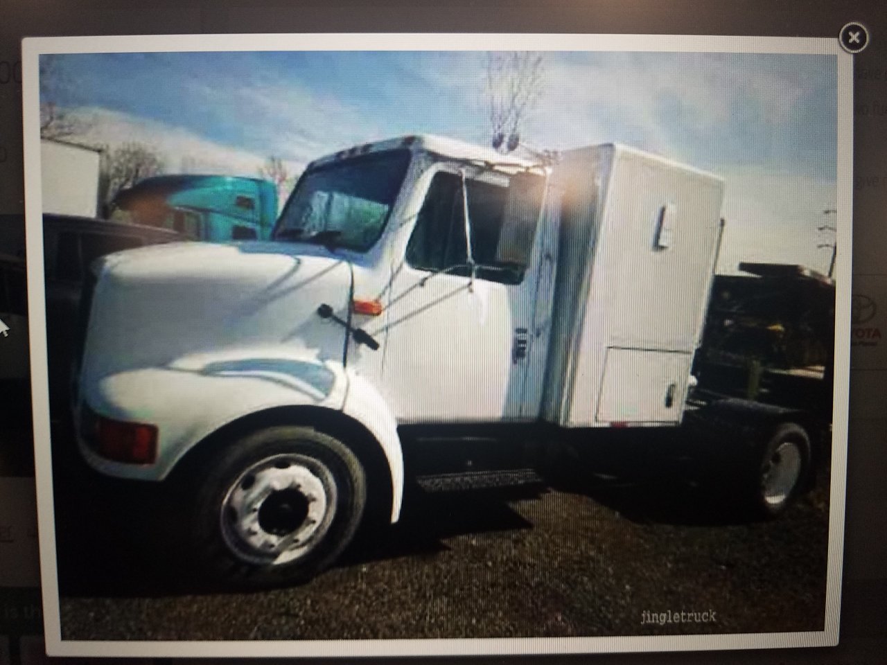

    I stumbled across this old thread and thought I'd drop two pictures on here of what the conversation was headed towards. The talk of using a M/D truck and modified gooser turned into a stepdeck has been on my mind for a few years. It is slowly coming together.
    tnpete, Lite bug and Mattflat362 Thank this.

    What does that single axle weigh? My T600 is pushing 18K. But then again I have the 11.1 Series 60 Detroit and 10 speed. 4 fuel tanks, walk in sleeper with sofa and upper bunk. Plus metal bed on back. Figure the bed is pushing a Ton by its self.
    Hooked to the dump trailer. Hauling off an old deck.
