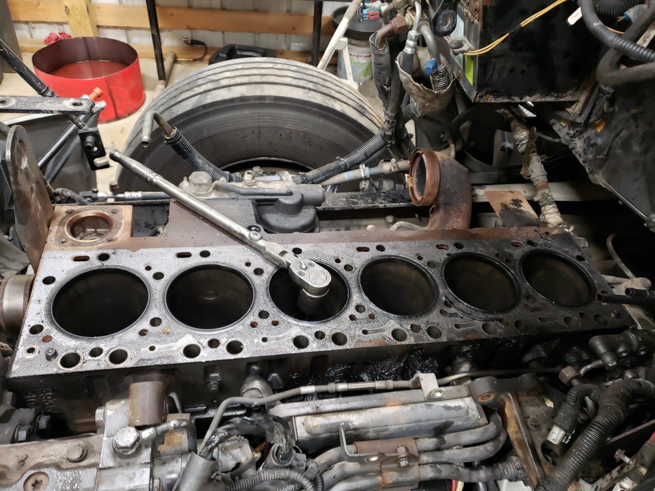

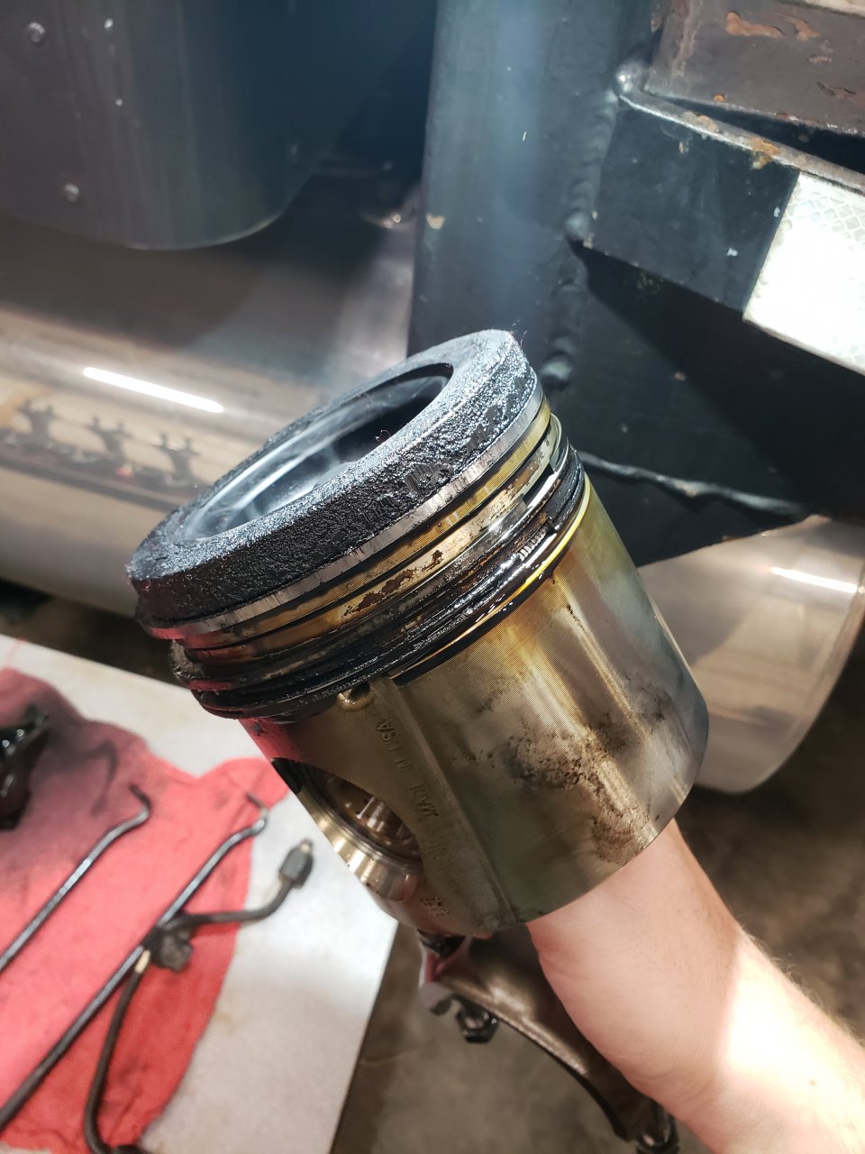

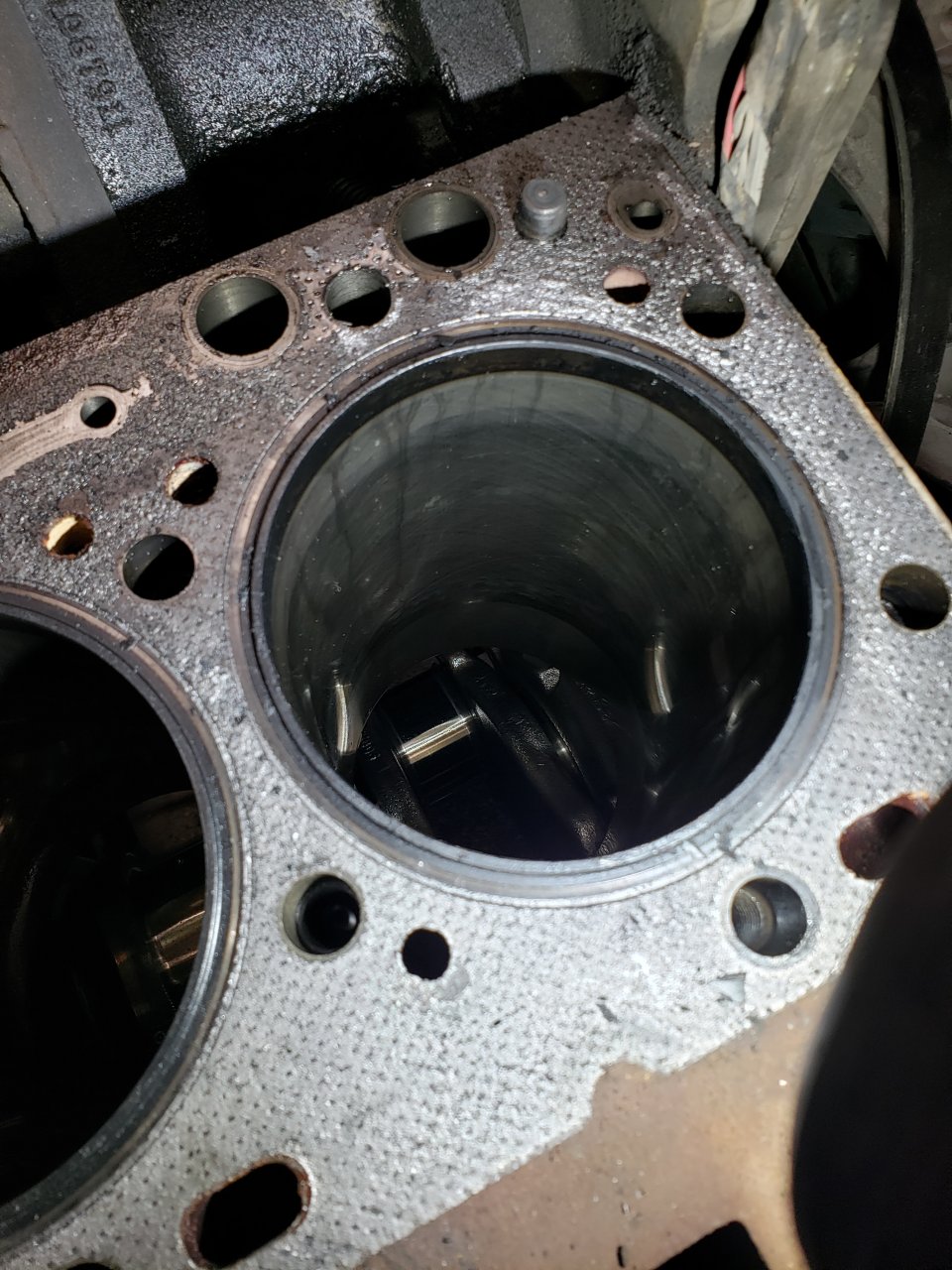

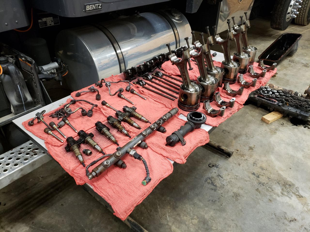

    No I haven't. Bought the truck with 717k on it and I litteraly just did an inframe here over Thanksgiving. The engine showed very little wear cylinder wise and was still holding great compression. Had a little bit of blowby but nothing wild. Did the rebuild right at 798k miles an 21890 hours. Only major wear was the connecting rods at the crank tolerances we're getting lose. So we went with new rods as well. Now have 5k miles more on the rebuild with no issues.
    Parts and labor ran me right at 16450 including the rods and a new injector that broke in the rear down. Turbo has a out 310k miles on it and doesn't show any major issues either 20211111_130539.jpg
