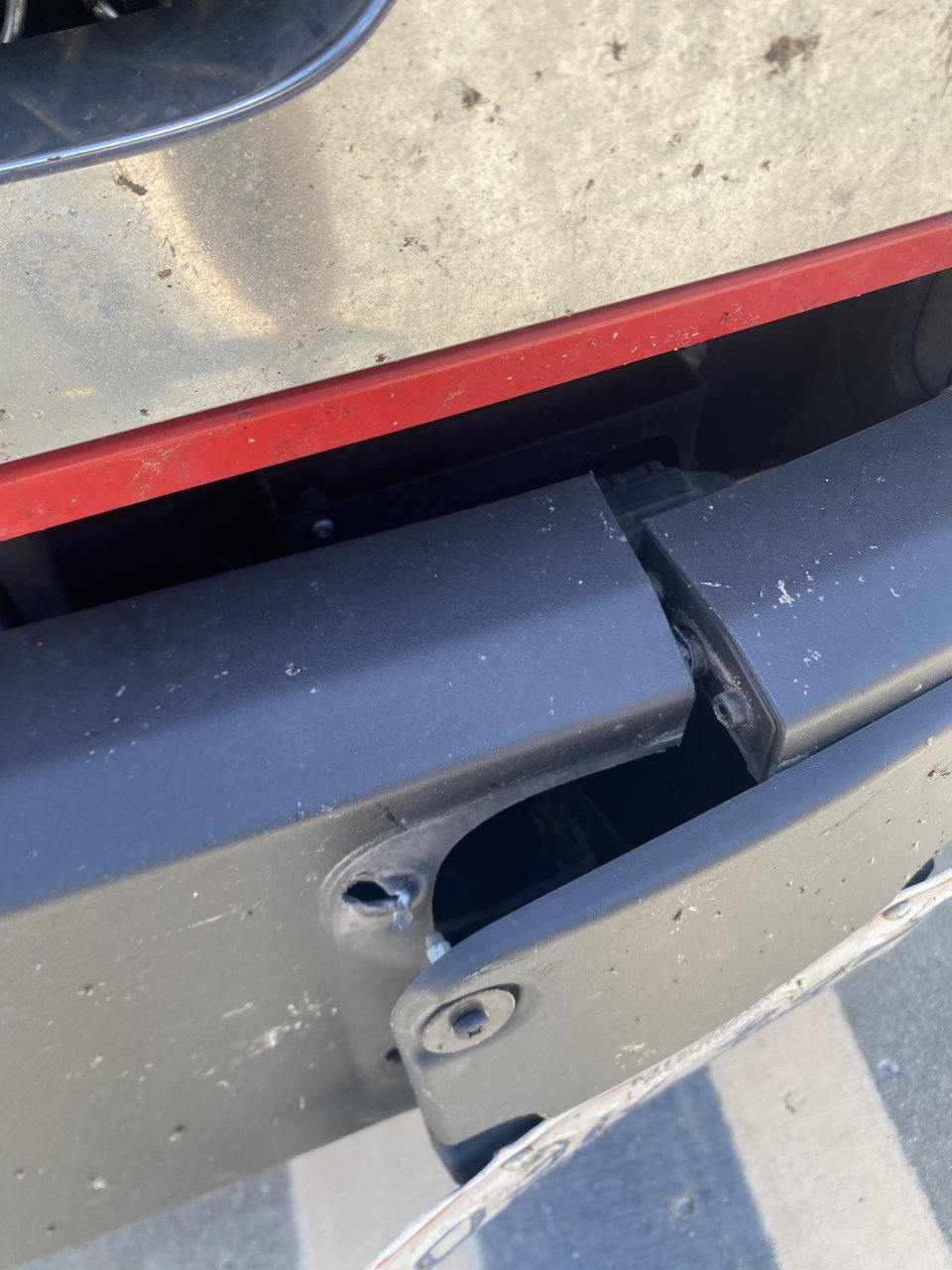

    Pulled forward to a curb so I could back up and I guess my license plate got caught on it and when I backed up, the bumper came undone a little. It looks like the screw hole widened. Would a zip tie do the trick.

    I would get some new stainless steel nuts and bolts and use larger stainless steel fender washers to hold everything together with the holes being that much oversized.

    I think I would try to do the same thing that got you here,
    Only in reverse. Try to get against something and push it back together a little.
    Then do the larger washer thing previously listed.

    I second what @AModelCat recommended. Repair it correctly and use a proper size bolt and nut with washers. If you visit an actual hardware store you can get black zinc plated fasteners so it matches the color of the trim.
