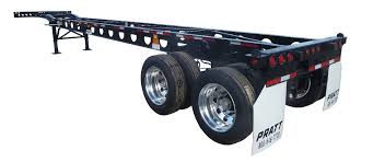

    They use this type of trailer. Its called a container chassis. When they put the container on top of the trailer it locks onto the pins you can see at all 4 corners of the trailer... Some guys pull their own trailer.. Most trucks i think use the ports chassis (im not sure how thats handled im not a can driver)... If you ever come to the pacific northwest you will see these trailera with 4 axles and lift axles on them. They get pretty crazy with how much weight they can haul.
    You can haul it on a flatbed as well. Like i have . some flatved trailers have container locks on them that do the same thing as the pins on the container chassis. Keeps the flatbedder from having to chain it down and strap it .
