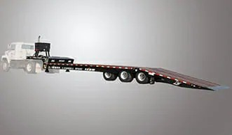

    One thing that I hadn't considered was recovery of your trucks if ever you wanted to go and retrieve one that was down. The height on the type of trailer that I showed would become a problem with your tractors, but most ag and equipment rental places like Cat Rental Store use either a folding tail or sliding axle trailer as they can load everything from manlifts to small excavators, dozers and loaders, and farm tractors on them. The deck height is nearer to three feet on them though, so hauling one of your semi tractors would put you well over fourteen feet I imagine. Here is a photo of a sliding axle trailer.
    For occasional use a Kaufman or other lessor brand would probably be just fine. Prices on the higher end trailers, like everything else, are insane now.

    The three axle versions can haul a 50,000 lb. machine easily. I'll see if I can find an example. Landoll's website will help to show you a variety of trailer types too. Landoll Trailers - Landoll
