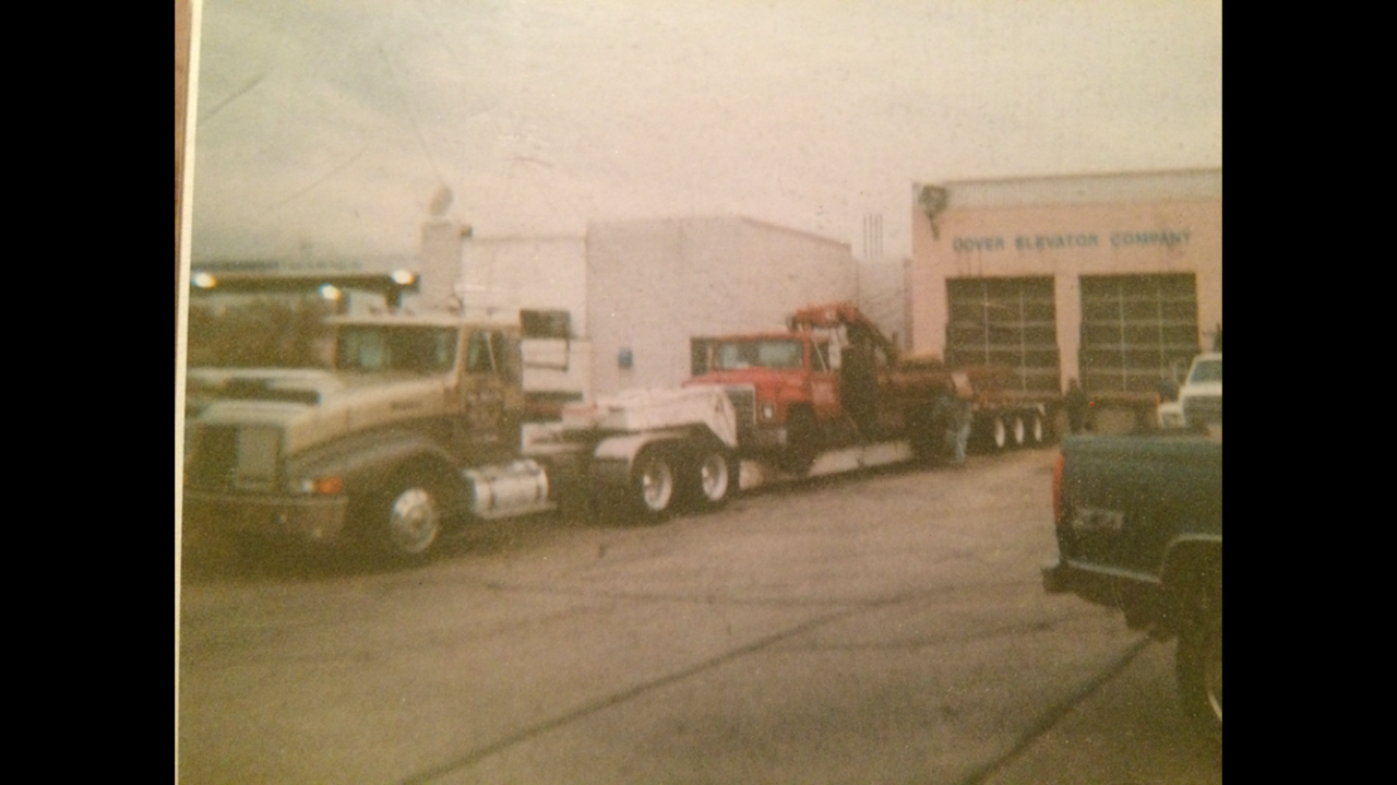

    We have a 21' well on ours. When I have hauled one of our tractors I back the last drive axle over the front trailer axle. More of a hassle, and raises the cab height a bit, but worse fine.
