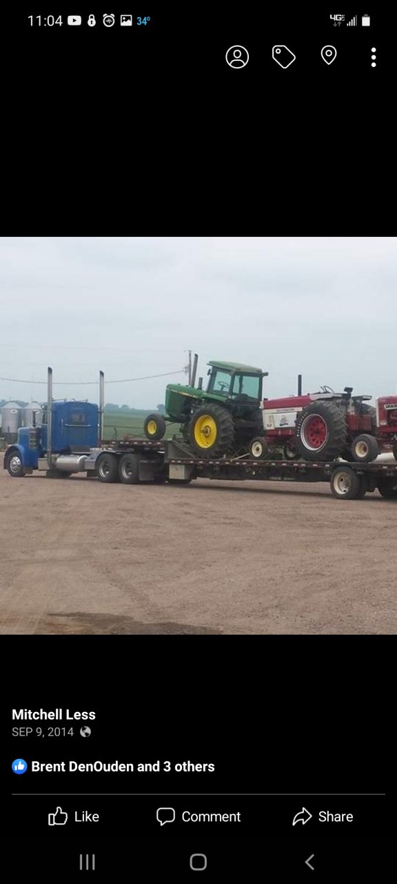

    4440. 10 something and yeah probably 806. I'm not a red guy, buddy and his cousin own the red ones. Going tractor pulling
