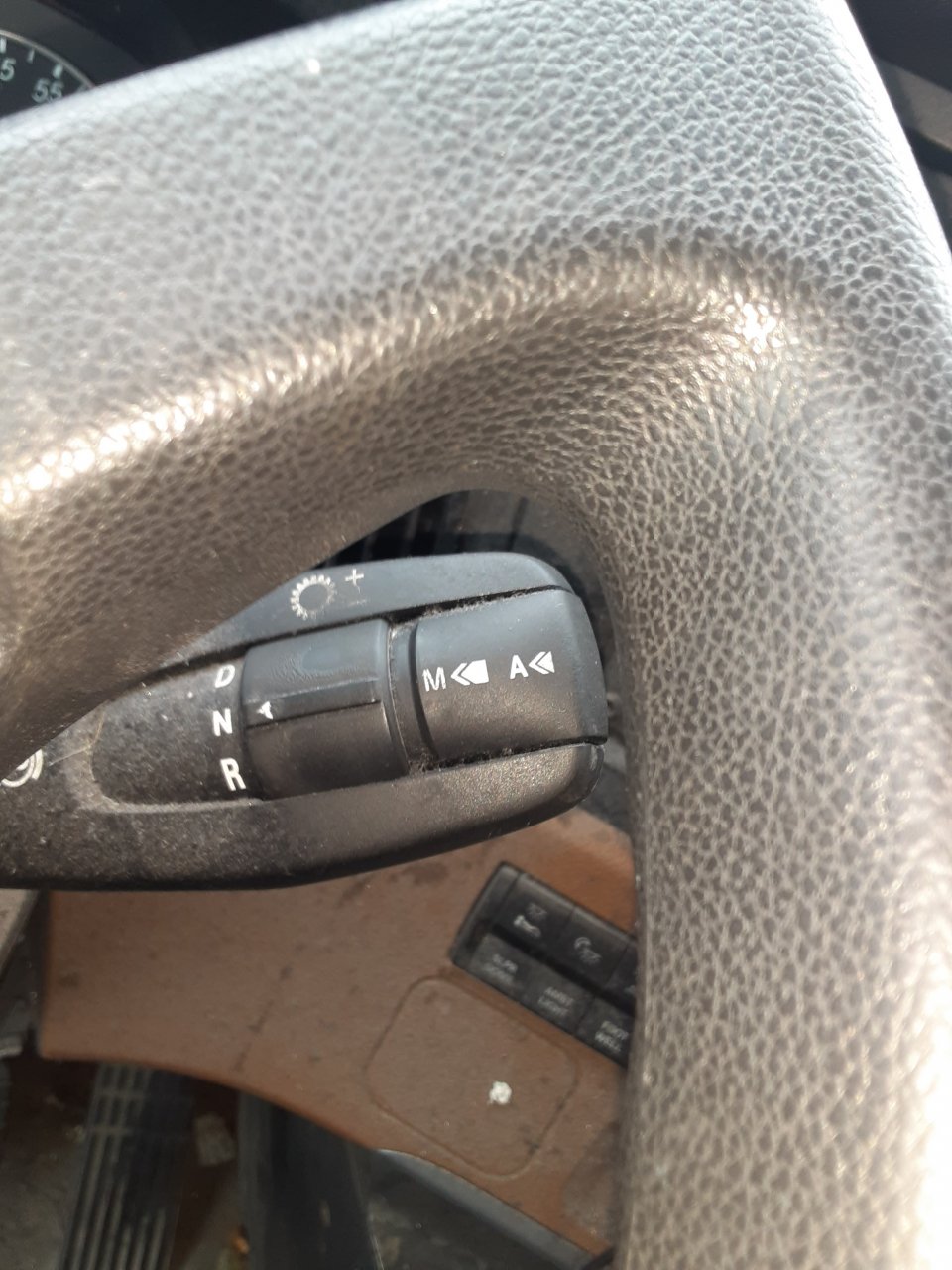

    You requested a picture of my shift lever. Here is a picture of my shift lever:
    As you can see, I have the manual transmission option as well. I still don't know how to shift gears in manual mode on my truck. How do you shift gears in manual mode?
