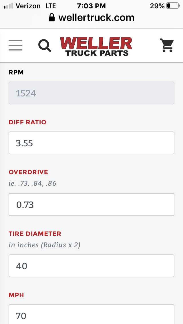

    I’m not sure I used the right tire sizes. 40” and 42”. 11Rs 22.5 are very close to 295/75/24.5, which seems to be the most common size for 13/355’s. I considered going from lo pro 24.5s to Lo pro 22.5’s. As I recall it would be a bigger difference than changing the rears from 3.55 to 3.70. I’ve been told 13/3.70s/24.5 lo pro are ideal in the hills of Ky and Tn. Maybe someone can chime in on proper tire diameter sizes. Mine runs out now @1500 rpm at 67 mph. I can’t say if my Tach is accurate though. Speedo is off by .04% Truck gets terrible mpg. Good on flat land, light loads. 1375rpm @ 62 mph. Use the calculator. My #s never match up right.

  8. Rideandrepair
    17,584
    56,954
    Aug 8, 2015
  9. Rideandrepair
    17,584
    56,954
    Aug 8, 2015
