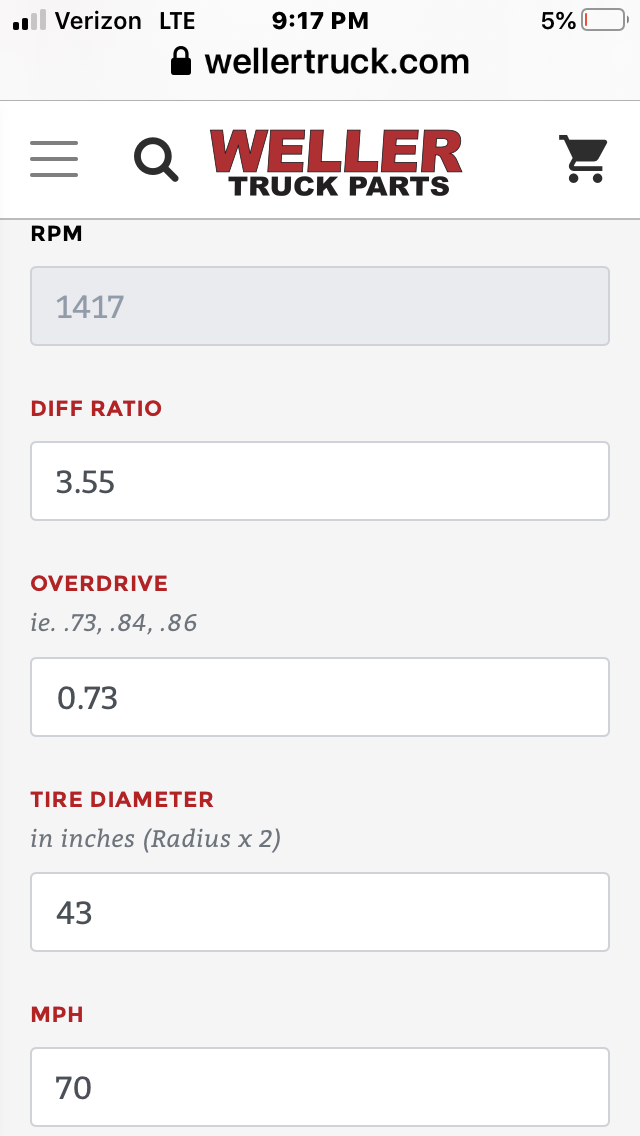

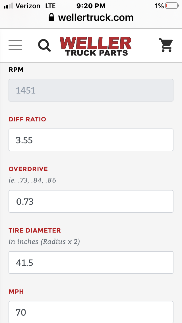

    094AF58F-7AF8-4309-9216-10D7DF73A428.png 22103675-5382-4A72-883B-EF428D41F732.png Might as well throw these two in there.

    The difference in speed is dictated by REV/MILES factor.
    Tire 1 has 500 REV/MILES.
    Tire 2 has only 475 REV/MILES.
    Tire 2 will move the vehicle 5% faster for the same RPM.
    Check on the manufacturer website and you'll see.
