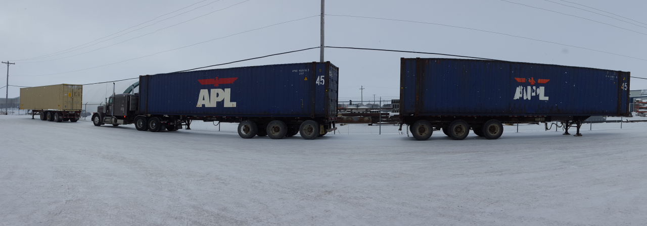

    The only time I ever did it was this past winter when I was presented with an opportunity to do it and wanted to try it (they talked about it in school, but we never did it). Did it with a single pullup and two GOALs.
    I don't see it being very common. Alley-docking and blind-side backing should be the most important thing they teach in school for backing (truck stops are not friendly for space).
