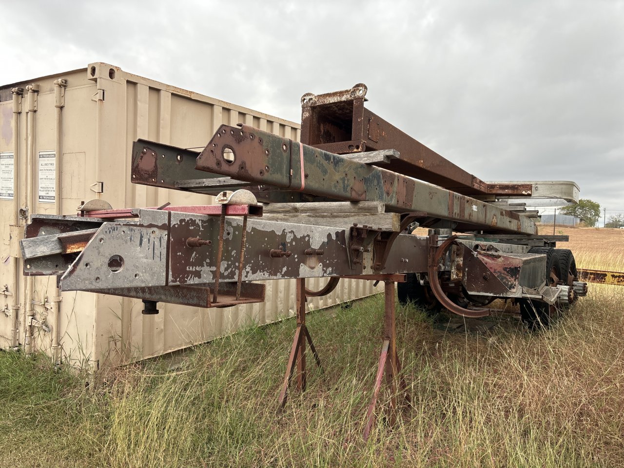

    I built a removable king pin just for that kind of stuff. Piece of 10” wide c-channel with hole cut in middle. Weld king pin thru hole. C-channel is made to be strapped on the bottom side of frame with u-bolts. Lift it up just enough to back fifthwheel under it. Lock it in and go. Pull it like a trailer.
    Oxbow and wore out Thank this.

    I was curious if anyone’s cooked up something like that. I was thinking angle iron welded on to bolt to the side of the frame but yours sounds simpler. Don’t suppose you have a picture?

    This is the one I have behind the shop now. White-WesternStar frames. Alum one is a ‘80 year model and 24’-2” long. With the stands I built I can back under it anytime to move it. I’ve pulled them from place to place with frames stacked four or five high.
    Oxbow and Heritage1lw Thank this.

    That’s perfect. Exactly what I was looking for.
    Wonder how the dot would feel about me rolling down the road with one of those holding a 379 to me. Sounds like an after darkness job lol
