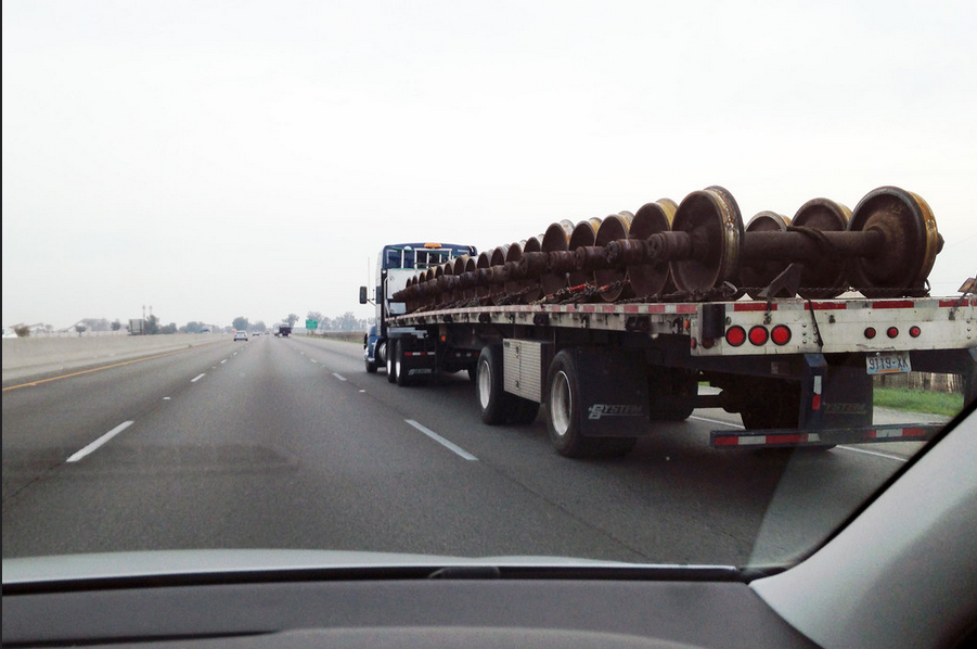

    Train wheels they run a "track" of 2x4 down each nailer strip to roll the wheels on. Usually 16-18 wheels on the deck, strap groups of them together and roll. Very easy load typically with backhauls of fresh wheels.
    Nailers on the outside of the deck will cover almost anything with a regular width track (car, van, pickup truck, etc) and that's if the shipper requires it. I am always watching other decks rolling down the road and I only once saw a trailer with nailers inside the frame being used for blocks on small coils (instead of a coil bunk) to hold the 8 foot boards in place.
