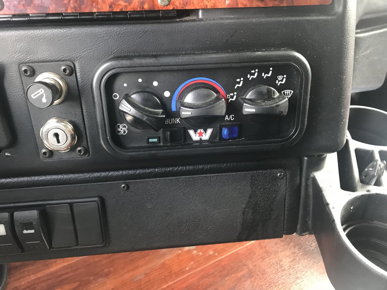

    I just replaced everything AC related beside the condenser.it took 4lbs and it blows ice cold.
    Only problem is if i put it on recirculation mode most of the air blows to the foot vents.frezzes my feet to death.any idea why it’s dumping most of the air in the foot vents???

    What truck and picture of controls?

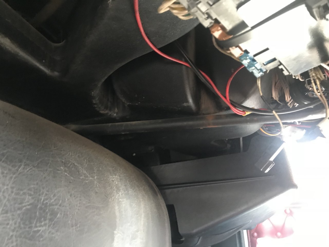

    Its 2009 4900fa.in the second picture, where the blower fan motor is i have water Dripping from there
  9. Cetane+
    Cetane+ Road Train Member
    1,304
    882
    Sep 29, 2013
    Albany, NY
    clean out your drain tube. its the plastic line coming down from the cab behind the passenger side front tire. Take it out of the mounting strap, that usually kinks it.

  11. Cetane+
    1,304
    882
    Sep 29, 2013
    Albany, NY
    That’s your condensation drain tube. If you have the manual levers for climate control that’s probably just wore out and you need a new one. If you have the electronic control for climate, it could be a whole Nother issue.
