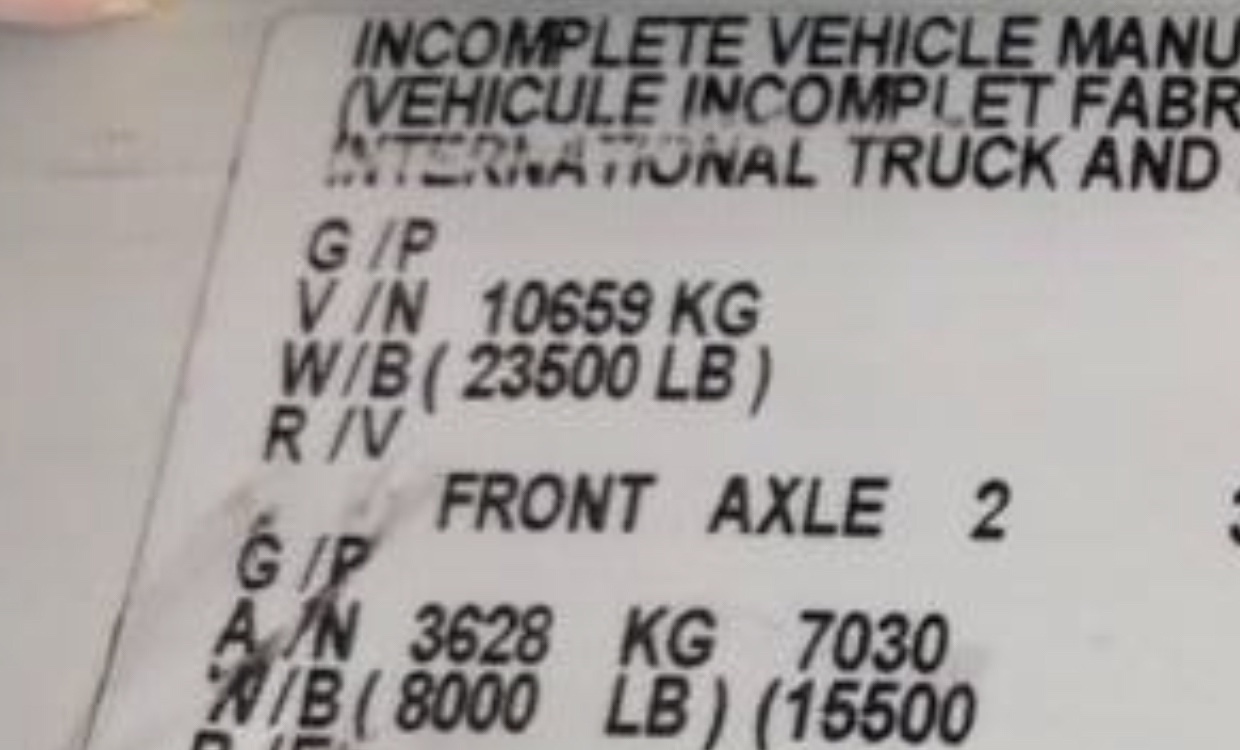

    I have a 2008 International 4300 24 ft. Box Truck, and I wanted to know what is the maximum weight I could load. The guy at the dealership said it could haul 60,000 lbs and that seemed off to me. It's a non CDL truck, class 6 rated.
    I also have a picture from the inside of the door

    Now that I read your label.
    Your GVWR is 23500#
    Front axle 8,000#
    Rear axle 15,500#
    Take 23,500# minus truck empty weight
    That will give you amount of cargo you can carry.
    Cattleman84, COBB2070 and Tb0n3 Thank this.

    Gross Vehicle Weight Rating 23500 pounds.
    Find yourself a CAT scale. Put it on there. empty with full fuel and you in it. Pay the 11.00 get a nice yellow ticket showing your empty weight.
    It should be somewhere below 23500.

    No the gvw is 23,500 lbs, nothing more.
    The guy with the badge will tell you the same thing.
