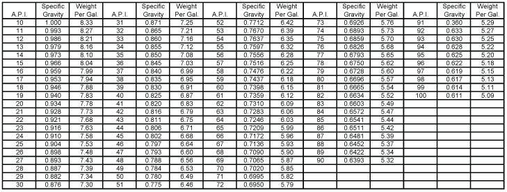

    We always used the rule of thumb: gravity +135 (daycab) or 130 (sleeper) is the number of barrels you should haul to remain at legal weight. But all our trailers were 200bbl single compartmemt.
    Using the attached chart you can calculate the amount of weight you're carrying based on the gravity and the amount you loaded.
  8. Hillbilly1987
    Hillbilly1987 Bobtail Member
    8
    1
    Feb 11, 2018
    Thanks for the info. I been hauling around 170 barrels. Day cab truck. Figured I was pretty close to 80k
