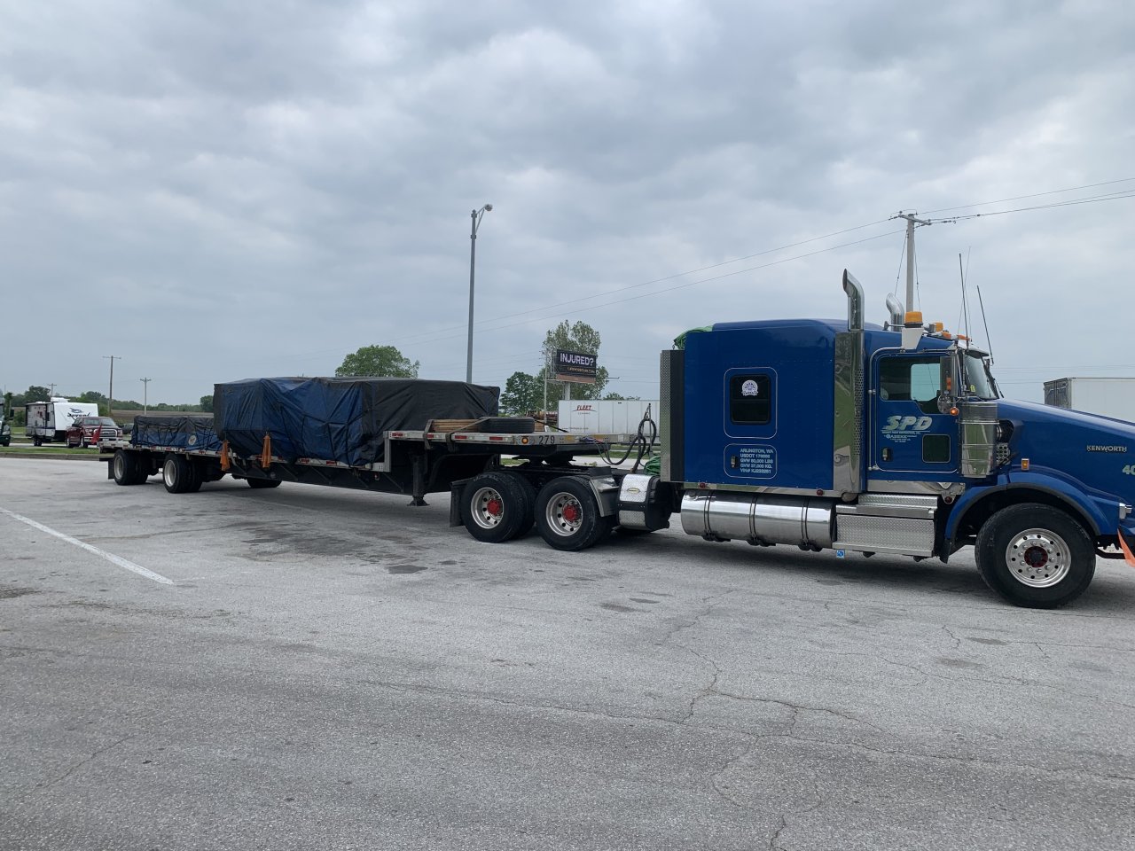

    Not sure what they are talking about. Plenty of room for the HVAC unit under the bed. Same with our 680’s. 74909927-EAA2-46FB-8C55-A28C25C68858.jpeg
