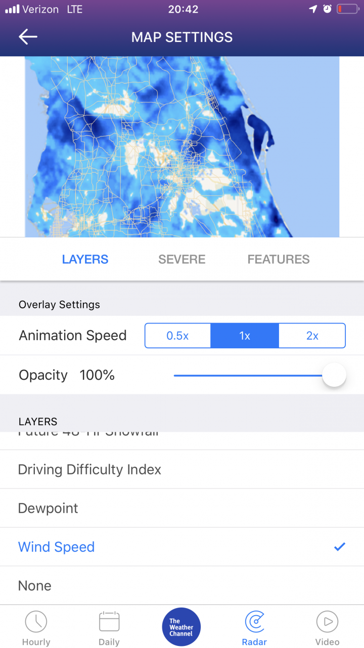

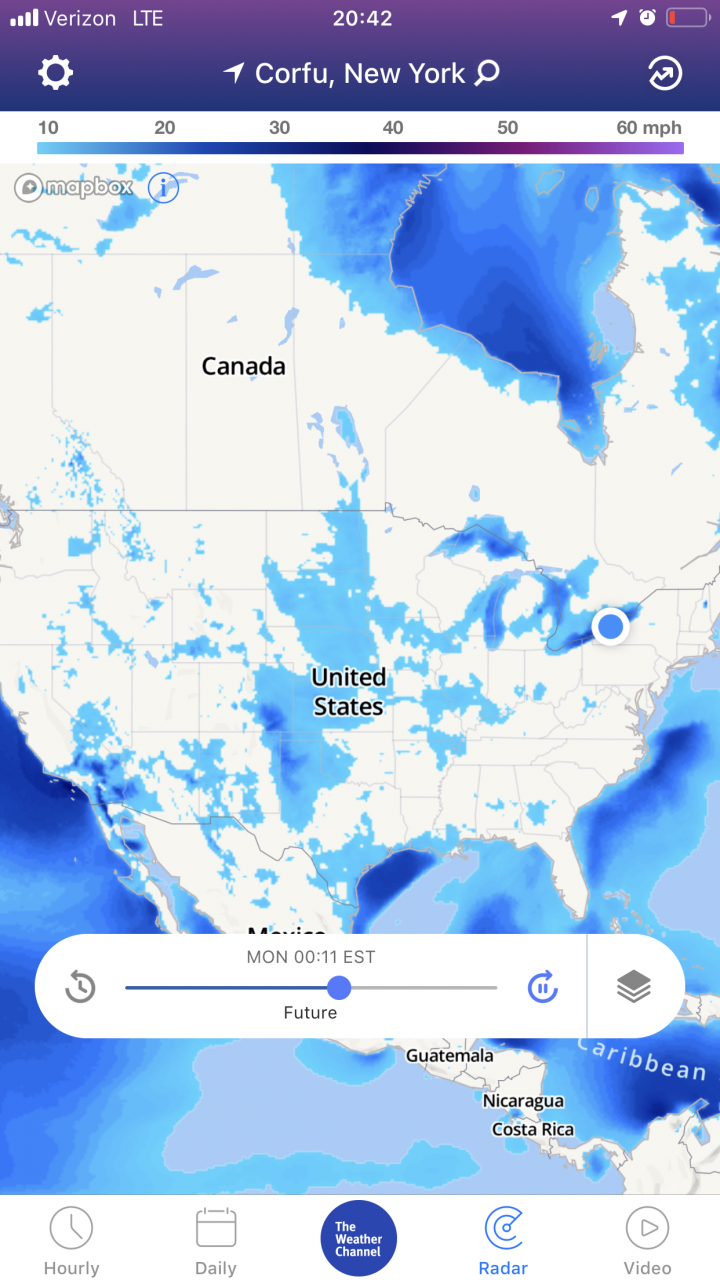

    I personally just slow down when it’s very windy. It’s also good for the MPGs. You can use The Weather Channel app to look at the current and future wind speed.
