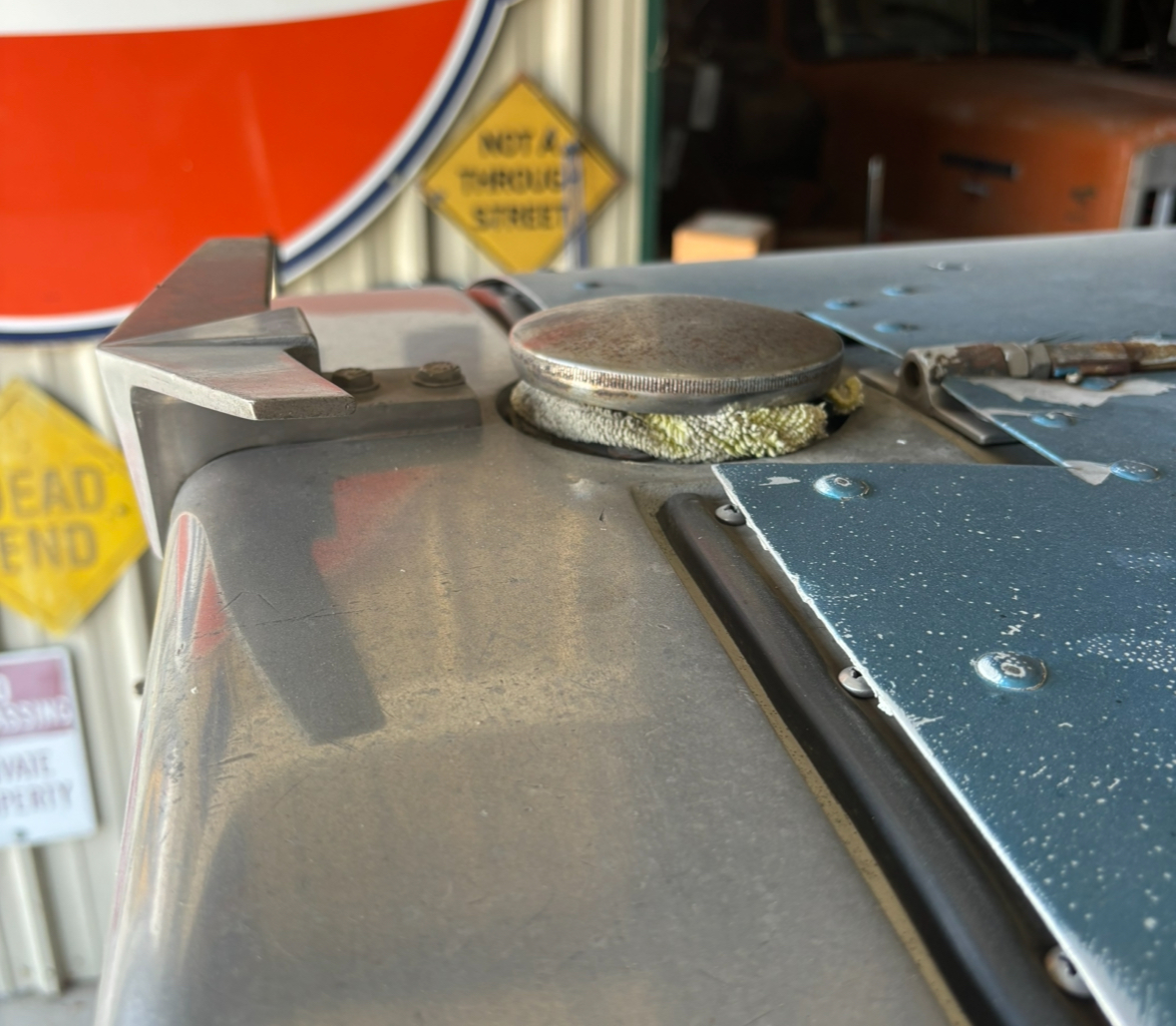

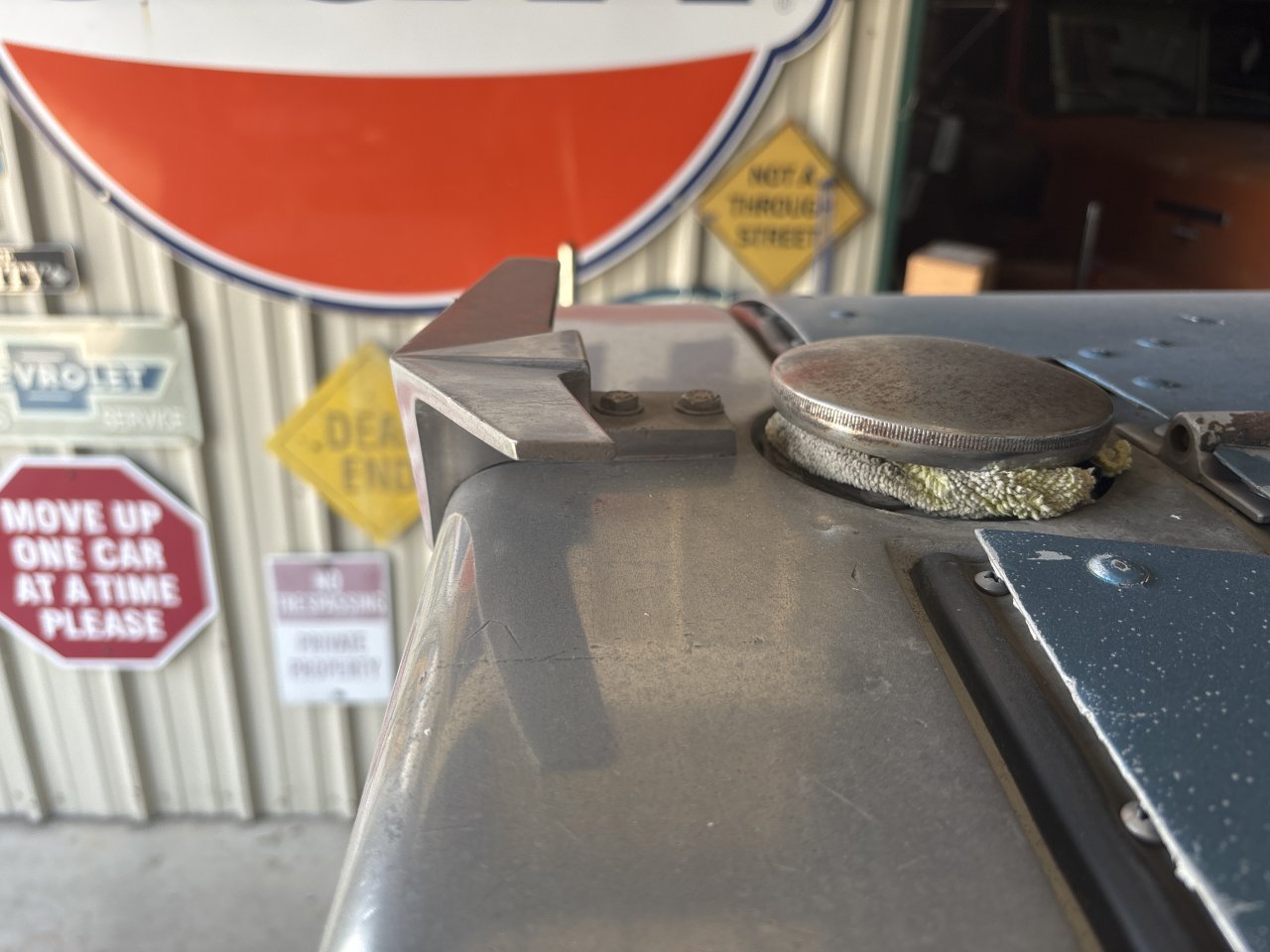

    Same with all my stuff. They have their sweet spot. Same with oil consumption. I have a micro fiber towel wrapped around the old rad cap on my 351 because every time I top off to “spec” it spits it back out on the windshield. Lol. Then it will run forever with the top 4” of rad empty no problem.
