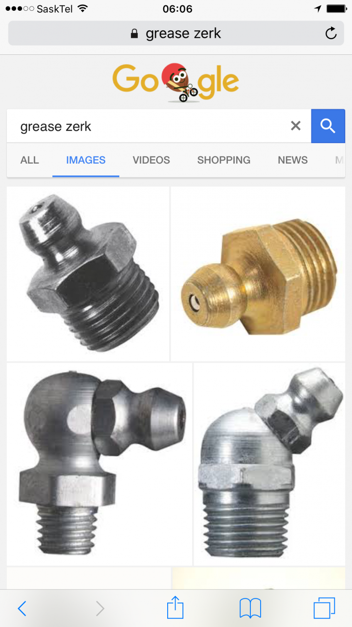

    At a minimum you just need a grease gun that takes a full cartridge of grease and a rag. Crawl around and under the truck and put grease into any fitting that looks like this:
    The end of the gun has a fitting that will kind of snap over the round nozzle looking part of the above. Get a gun with a rubber hose, not the solid steel pipe, as these fittings can be hard to get at.
