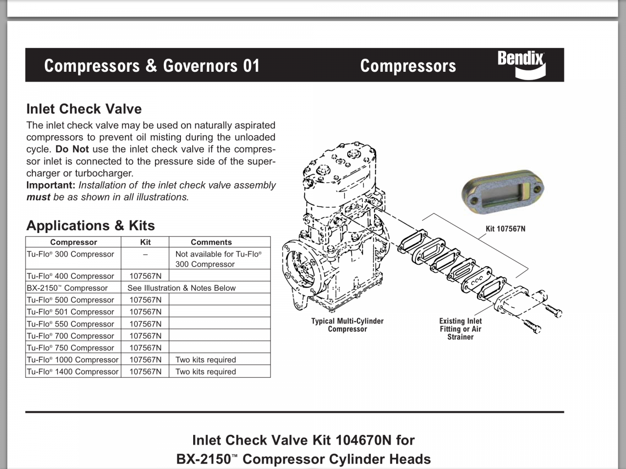

    That's why the check valve is there, so if you run it off the air intake, oil mist won't get in there. From what I heard, when the compressor is on the unloaded cycle they can blow oil mist.

    I change mine every oil change. $5 filter. With the reed valve it keeps the oil mist to a minimum. But you will still get some floating up wind just not as bad. Oz one thing you could do is install a remote air filter for compresser if you don't want to plumb into intake piping.

    Too late, I've already bought everything and I'm just about to bolt it all together as we speak. The check valve was$250!
