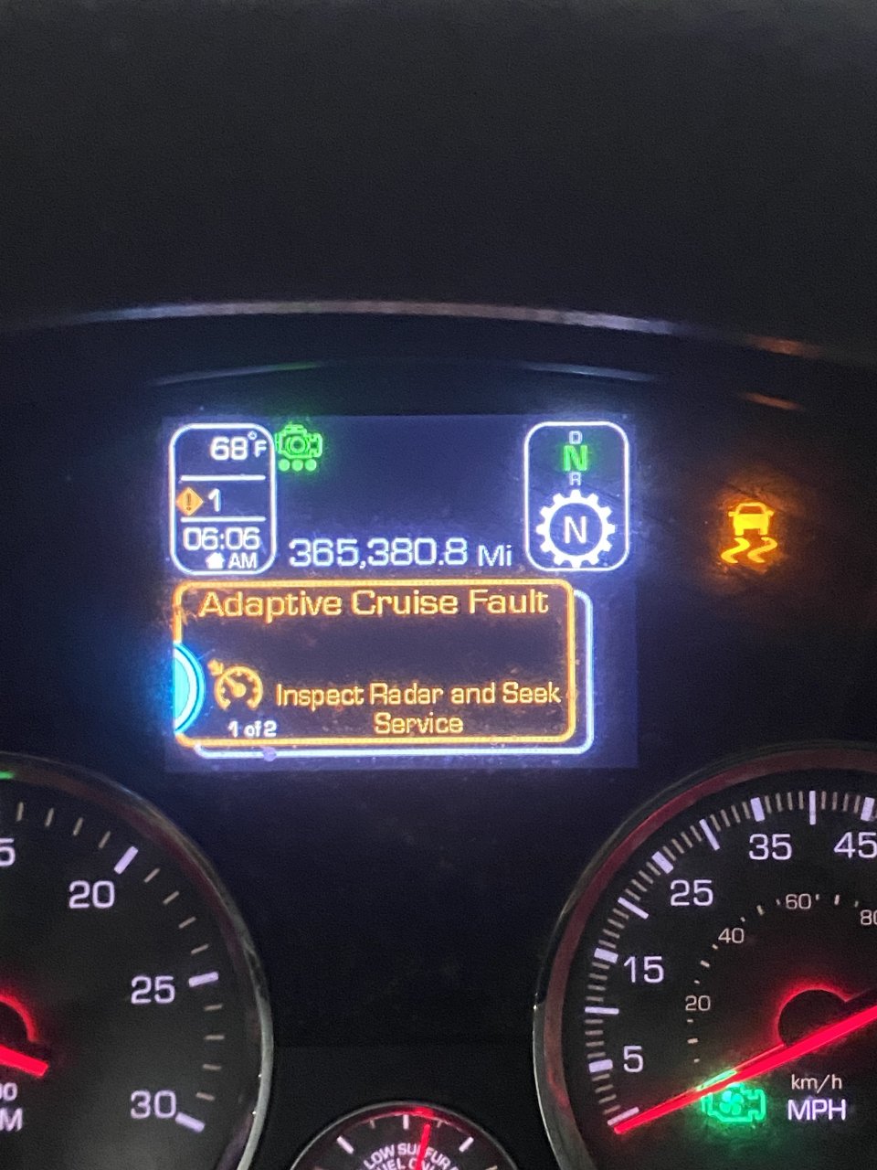

    Just got my truck out of the shop after 2 weeks. Because I had these 2 lights on plus an ABS light and TC light. They said the radar sensor had a broken bracket so they replaced it. I got the truck back then drove and the ABS light and TC light never came back on but these 2 lights in the pic came back on. I can’t really afford to be out waiting for my truck to get fixed. Is this something urgent or can I get it fixed in December?

    If something struck the radar hard enough to break the bracket, then the radar unit should have been replaced also.
    The harness should have been inspected.

    Had ABS and TC come on a 2019 Cascadia and it was a wheel speed sensor. Didn't say anything about radar though. Just throwing it out there.

    ABS might get you in a little trouble. The other ones, not so much.

    So, your cruise control and your traction control are not working. Sounds like a wheel sensor issue......

    I’ve had that pop up before, but the cruise still worked, only without the radar so you had to watch it like we did way back in the stone age.

    Yellow warning light usually are not urgent. The red ones definitely are.

    I wouldn't worry about that. It doesn't impact the basic operation of the truck.
