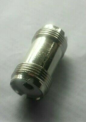

    You need what is called a barrel connector and a jumper. The barrel connector looks like the connector off the back of the radio but with both ends the same, it is about two inches long.
    The jumper can be bought under five feet but where is the question, I make my own.
    Don't cut the connector off the end of the antenna, you can't splice it.
