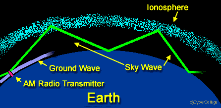

Longe distance radio communications are acomplished by the signals being refracted back to the earth's surface off the layers of the ionsphere.Many factors come in to play here like:Sunlight/darkness at site of transmission and reception,Season,Sunspot cycle,Solar activity,Solar activity,Polar aurora.By choosing the right frequency under the right conditions long distance communications are possible.
Take an AM broadcast band radio and during the daytime, tune from one end of the dial to the other and note how many stations you can hear.Do the samething after dark and you will hear many more stations after dark.
During daylight hours you will hear local and semi-local station via groundwave propagation.The Ground or Surface Wave, which travels directly from the transmitting antenna to the receiving antenna following the contours of the land or surface of the sea.
At night you will hear many stations at long distances as their signals are being refract off the ionsphere, this is skywave propagation.The Sky Wave, which travels upward and at an angle from the antenna , until it reaches the ionosphere and is refracted back down to earth at a distance from the transmitting antenna dependant on the angle it is refracted by the ionosphere.
