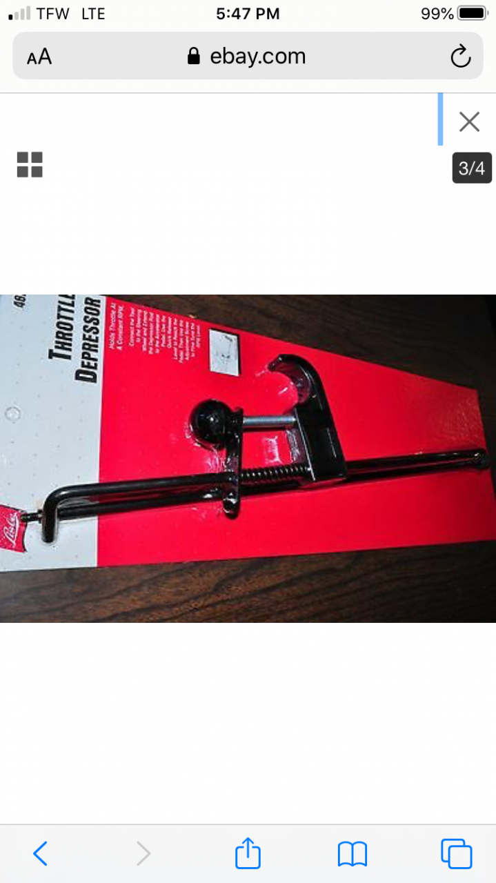

    Should only idle for 30 minutes at that point. Doing that trick with the accelerator depressing device won't change it. I've tried all the normal tricks because the EPU doesn't do worth a flip when its 117 outside.
