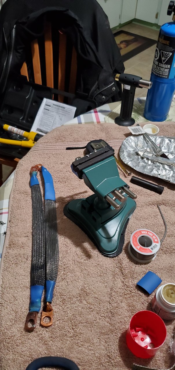

    Wish i had a solder pot for this,it would be so much quicker..

    ok in the pics, (to me) just ordinary "grounding" straps......

    Yeap thats all it is..You can make your own or buy them..
    1" braided i got in a roll,bought some copper eyelets(lil to big but they will do the job)and i crimp,fill with solder then cover with the nylon sheathing and heat shrink on the ends..

    Feels like it took forever and me arse is numb but i made 8 6" straps and 2 15"..Should be enough for some better bonding than what i have now...
