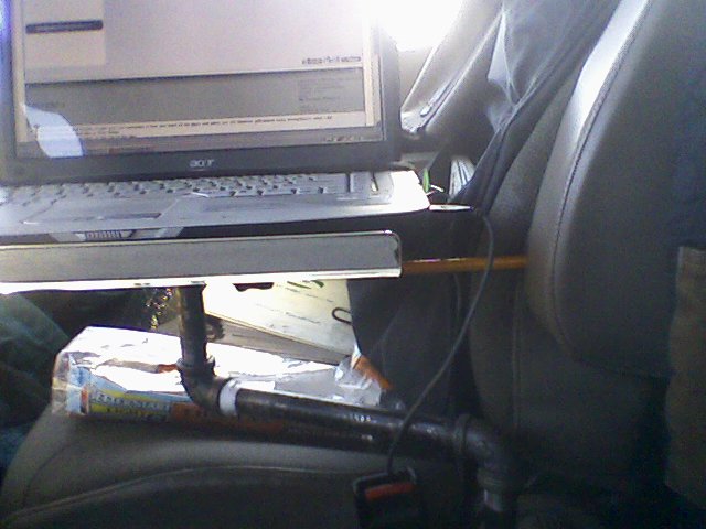

  5. wsyrob
    wsyrob Trucker Forum STAFF Staff Member
    5,295
    4,727
    Sep 14, 2007
    Winston Salem
    Yep best bet. I mounted mine to the seat belt bolt. Moves up and down with the air seat. Probably be less than $40 if you get everything at the hardware store. I bought mine off EBay for around $40. It had a plexiglass top. If I had to do it again I would just make the top out of plywood.
    MoneyCat and TheRumRunner Thank this.

    Cool looks like you can swivel it to view movies from the sleeper.Thanks for the plywood platform idea.Possibilities are endless
  8. wsyrob
    5,295
    4,727
    Sep 14, 2007
    Winston Salem
    I can actually swing it to use sitting on the bunk too. The air seat adjusts the height.

    Were you worried about leaks w/ that teflon tape on there?:biggrin_25525:
  10. wsyrob
    5,295
    4,727
    Sep 14, 2007
    Winston Salem
    That joint wouldn't stay tight with the laptop stand level. There was not enough thread for another 360 revolution. Teflon tape gives you a different set point.
