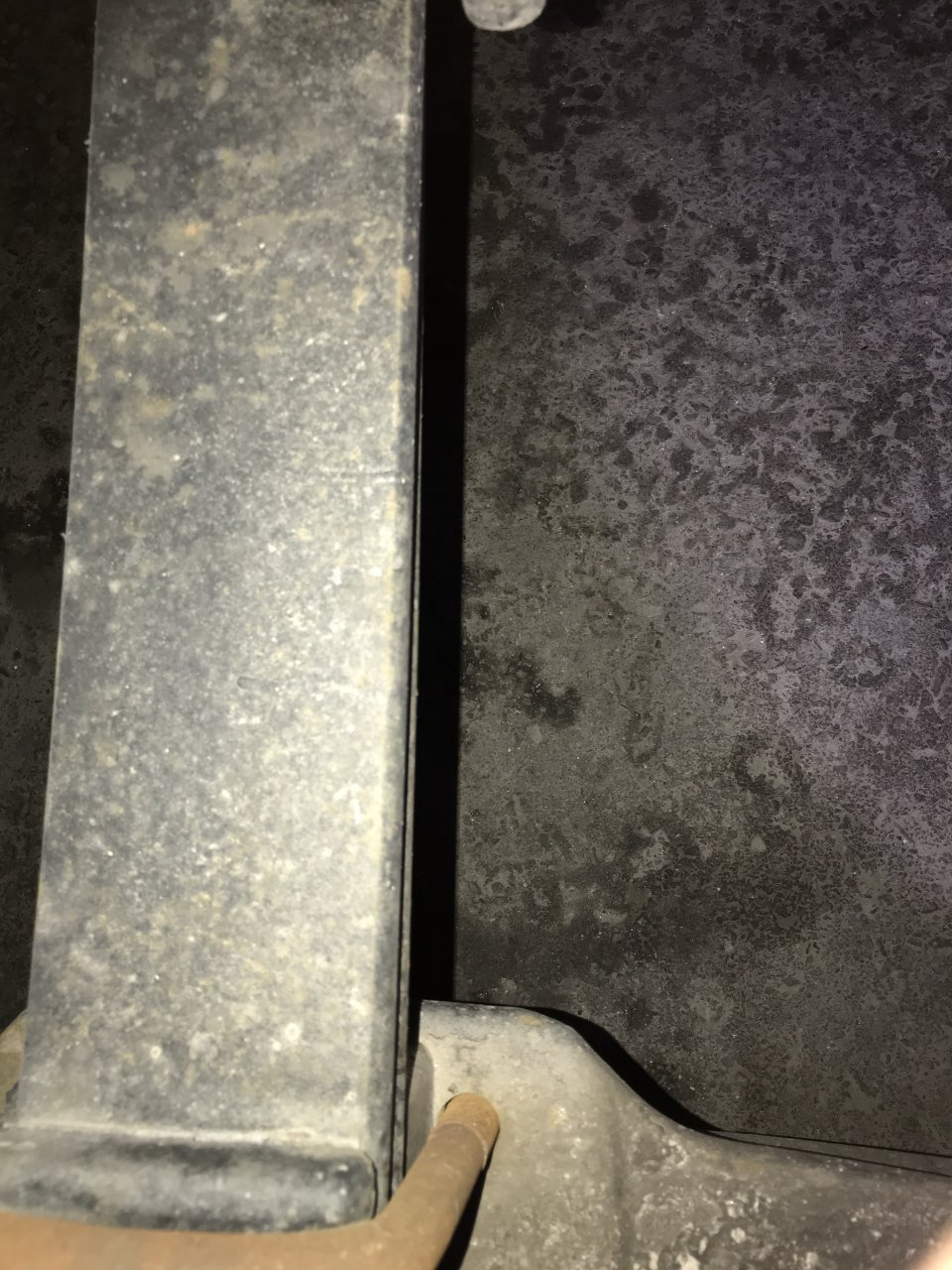

    My steer axle leaf spring on the passenger side is shifting (image below). The one on the driver side hasn’t shifted much. I got some new leaf springs installed about 2 months ago. How much shifting is normal? My steer tire wear is looking okay so far.

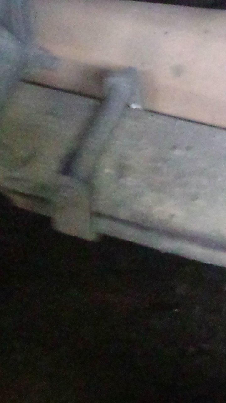

    U-bolts might have loosened up.

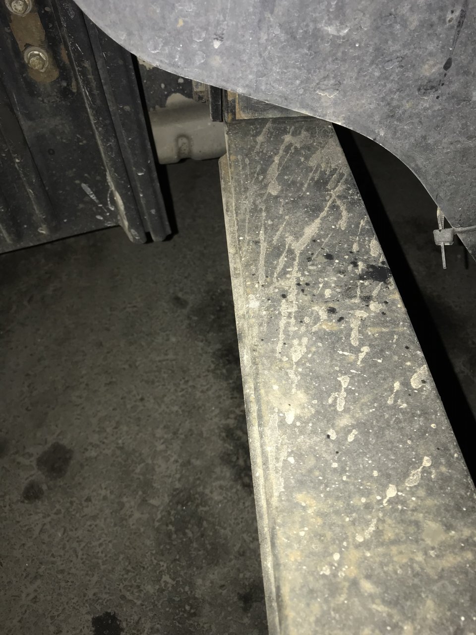

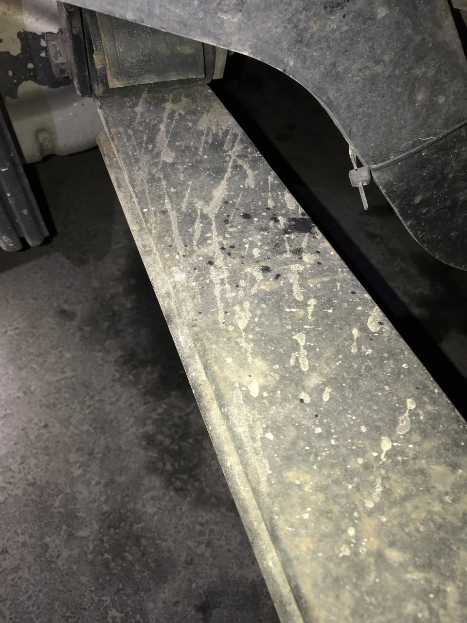

    I have these two other images of the same leaf spring. The one showing the u-bolt is the side of the leaf spring closest to the front bumper. The leaf spring is sticking out by about .5 to 1 inch.
    Will try to get better pictures. The previous leaf spring I had on the passenger side also shifted like this one. Maybe there is something wrong with the brackets. The reason I replaced the leaf spring was bacause my truck was leaning toward the passenger side. The mechanic had said that the leaf spring had flattened. The new leaf springs really did help with the leaning.

    I want to see your spring eyes-These pictures don't show too much-I see where it spread on first pic-
    The spring eye (Where your shackle bolts to frame and your Pins and Bushings get the Most abuse from all your turning you do while loaded.....Those are to be Greased and Checked regularly-
    You U-bolts in the center section bolt to your Steering beam- those Need to be Very Tight,VERY TIGHT......Anything Loose will cause Popping noises and premature spring sag and spreading of the spring-By which seems to be your complaint.

    Rust and corrosion act like a lubricant of sorts too. When I do springs and stuff like that I buff off all the rust on the mating surfaces of the parts. Helps keep everything together tight.
