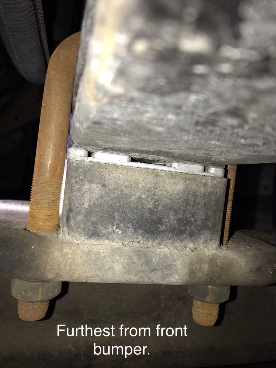

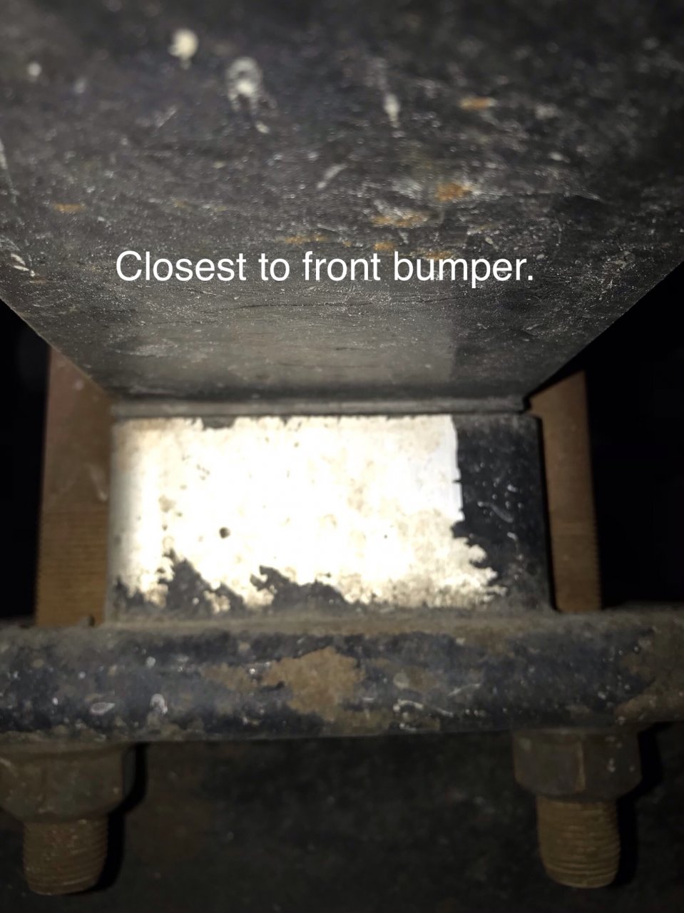

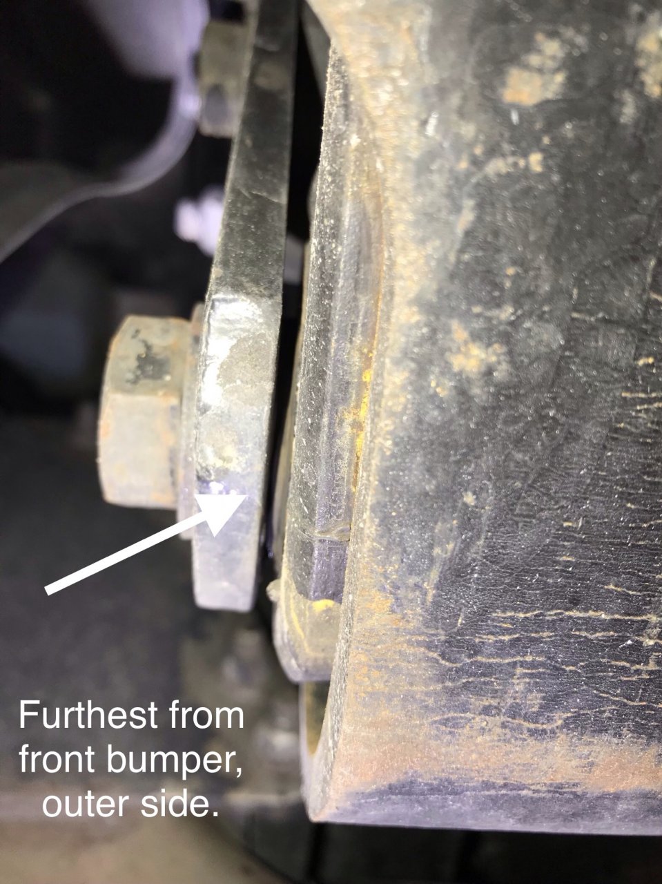

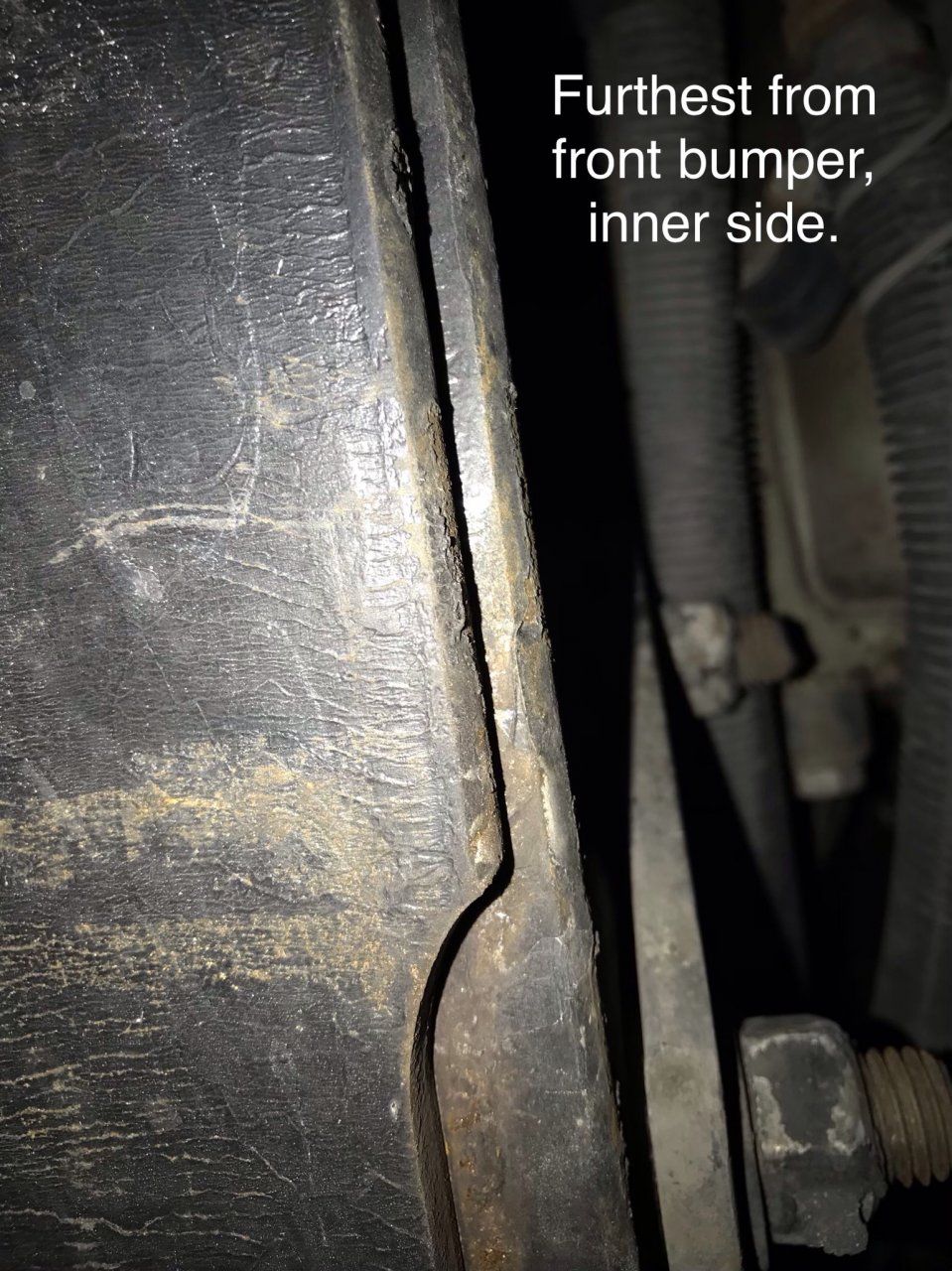

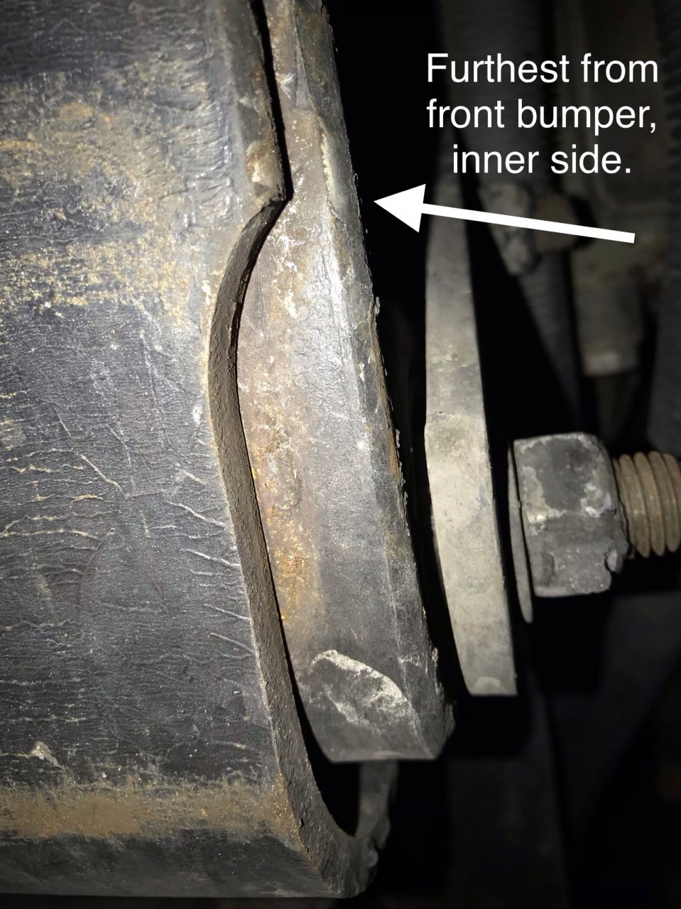

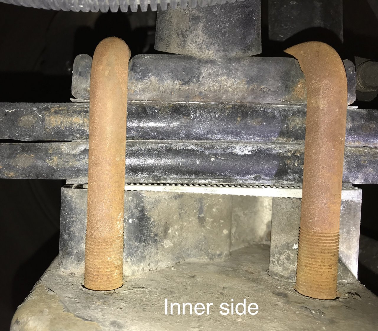

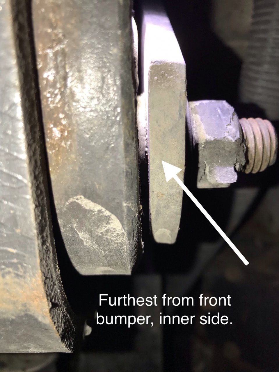

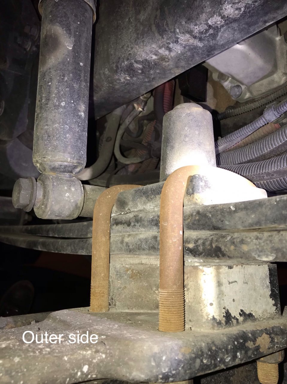

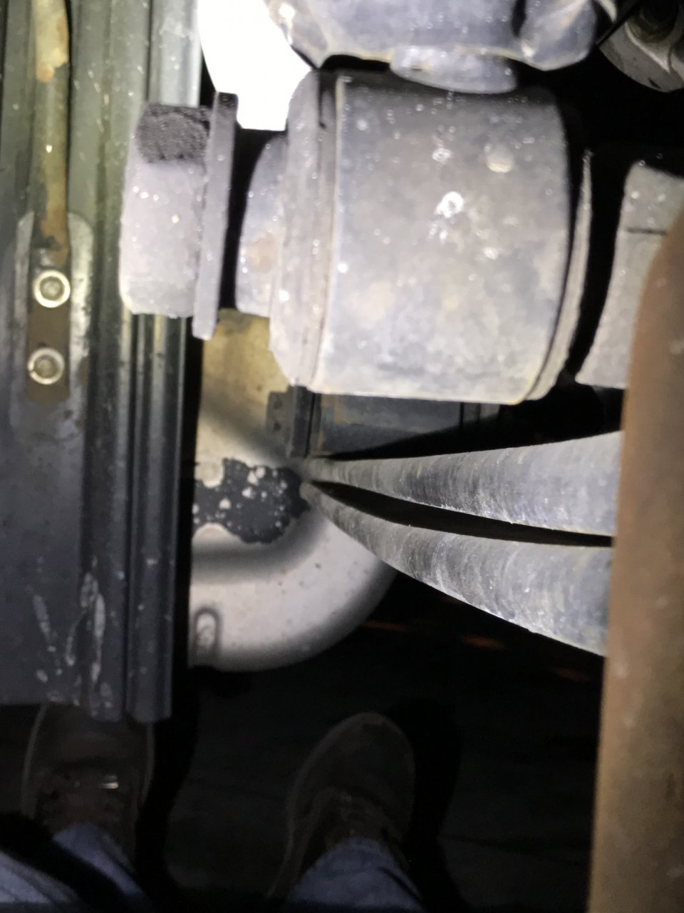

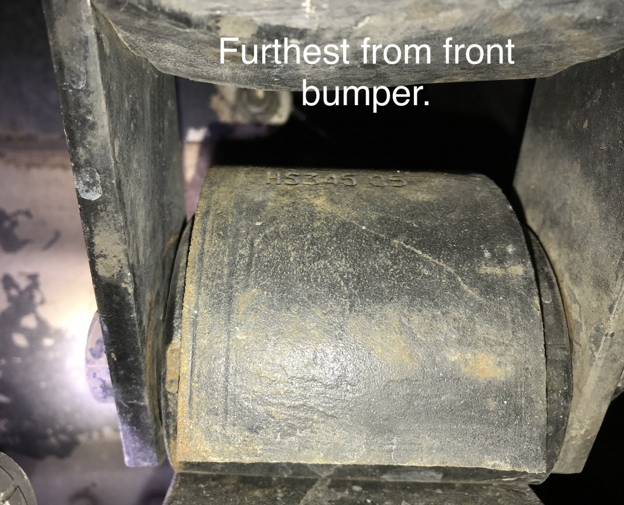

    Here are some other pictures of the leaf spring on the passenger side.

    By looking at those pictures- I cant see anything too bad

    Before I changed my leaf springs about 2 months ago, my steer tires were not wearing evenly. I tried all sorts of things. It looks like the flattened leaf spring on the passenger side was to blame. My truck is no longer leaning to one side even though now my leaf spring has shifted. To be honest, the leaf spring shifted in only a few days after they installed the new leaf springs.

    Im assuming they reused those U-bolts- Those have to be changed also cause they stretch

    I do not remember well. I am going to say they probably did change them. The leaf spring mechanic shop I use doesn’t use original Freightliner parts. That may explain why the u-bolts oxidized very quickly. I will check my receipts to see if they changed them.
    Right now I am keeping a close eye and measuring my steer tires for any signs of excessive uneven wear. If I see it, I will have to take my truck to a different leaf spring shop. I wish I could do this work, but I am not sure if I can pull it off. I do have two 12 ton bottle jacks, but I am probably missing other tools like a high torque wrench.

    There was a post on here about tire wear caused by the rubber spring end bushings. If I recall correctly it was posted by GrapeApe about Freightliners. The problem was corrected with a different style bushing.
