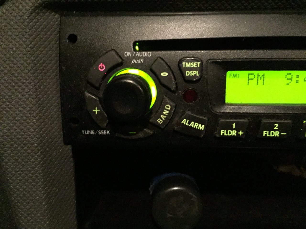

    Can anyone tell me how to reset the clock on my 2016 Freightliner Cascadia? I checked the owners manual and was unable to find any info regarding the clock.

    I just push buttons till it does what I want.
    But seriously does your radio look like this?
  4. lots of character

    On a 15 it's push the volume button in till the clock starts blinking then use same knob to change time
    muchostrange Thanks this.

    If you are talking about the one in the dash you have to go on page 7, click the arrow button on the dash and select time.
    Choose the right time zone and turn on the daylight saving option wich is off default.

    Turn the radio on, push and hold down the display button and the clock should start to flash. Use the up/down arrow to move hrs, then push display again to change the min.
    Ysmkyle, Stevewjr88 and muchostrange Thank this.
