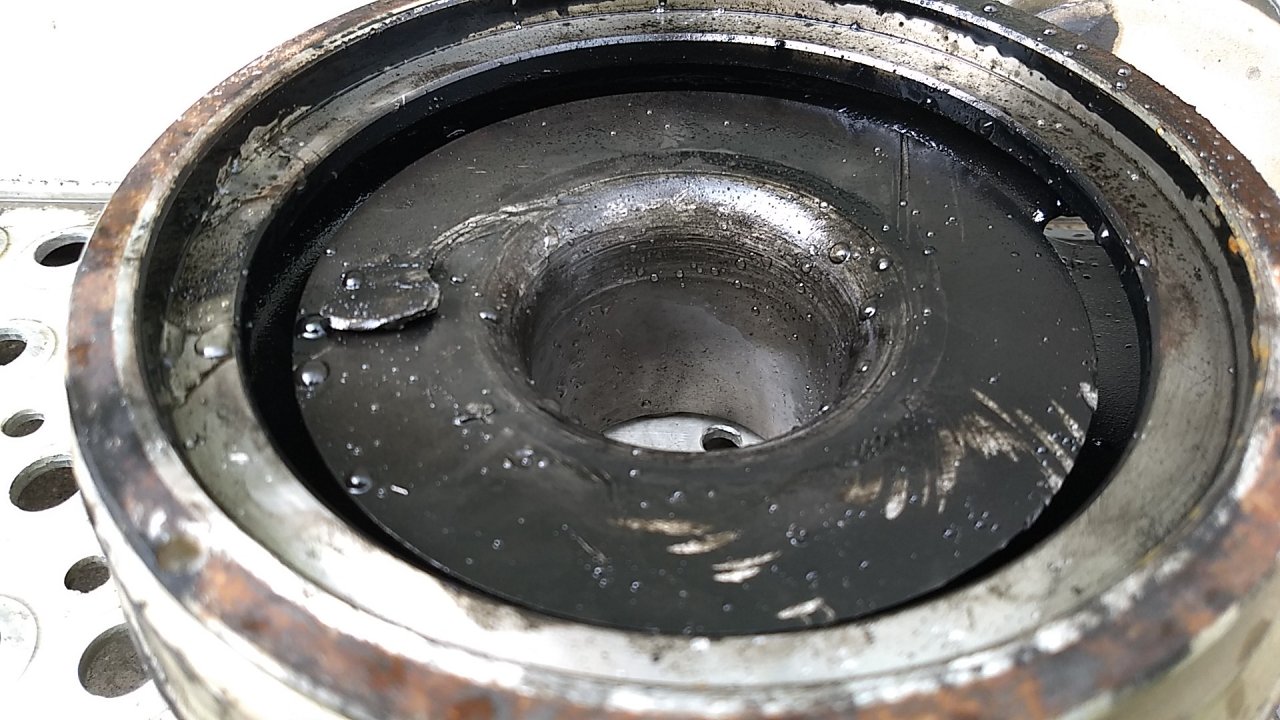

    2019-05-24_121040.jpg 2019-05-24_121158.jpg 2019-05-24_121056.jpg 2019-05-24_121112.jpg 2019-05-24_123433.jpg 2019-05-24_123624.jpg 2019-05-24_123821.jpg 2019-05-24_125920.jpg
    Thanks Heavyd, very helpful indeed. Here's the aftermath
    Broken shaft, piece of compressor wheel fused in the housing, turbine wheel milled down, whole lot of damage.
    Question to Heavyd:
    Is there any sealant required to be used on mating surfaces between hot side housing and the cup that seals exhaust gases. I had really hard time to remove that piece form housing, it had lots of rust buildup after getting it out I thought there must of been some sealant involved, I may be wrong but wanted to hear from a professional. Any tips on cartridge installation?
    And how crucial is new turbo feed line as it looks like another knuckle scrapper, lol
    I cleaned up piece of tubing where o-ring is located with 500 grit sandpaper, everything looks great.
    Now I got turbo seal kit, it looks like it contain more o-rings (I understand it service both turbos) but still there are some pieces that are there but were not upon disassembly. For example, turbo return line had orange o-ring only where turbo seal kit has those flat paper gaskets in addition to o-rings. Do these need to be installed along with o-ring? If so, which side goes up as one side has sealant around the bore.
    Based on stuff I've taken off, these are the only seals that I need replace,is this correct?
    I don't know where goes 1 purple o-ring, 2 black o-rings and 2 metal rings with rubber fused into them. Would you be able to shed some light on this, thank you
    Jacob

    The center section has no seals where it slides into the exhaust sections there. They just rely on heat and the v-band clamp to seal it. Just make sure it is nice and clean so you don't have to force it in to cause any potential damage. Clean all the rust out. They do not recommend reusing the oil feed line due to the flex section being handled during removal. The flex section gets hard and will crack if bent around too much and possibly cause a leak or even burst. So it is up to you if you feel it is ok to reuse. In the manual, they recommend to install the center section loosely, then install your new seals on the turbo inlet flange and the inlet pipe. Then install that inlet to the outlet of the intercooler. Then pull out the center cartridge slightly to engage the inlet pipe and slide the center section back home to complete that assembly. Sometimes this works and other times you still have to wrestle everything to line up, like you did when it came apart.
    Turbo drain line, just install the paper gasket, I put the orange side to the tube.
    The others seals are left overs if you did take the lower turbo off. If you also replaced the oil feed line, it intersects the oil pressure sensor and the other seals are for that.
    Just for fun, warranty pays 2.3 hours for this job! LOL!
