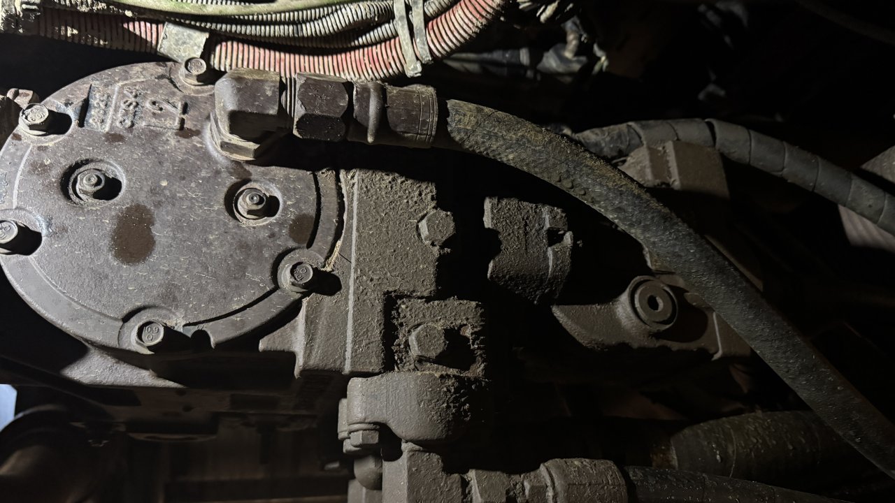

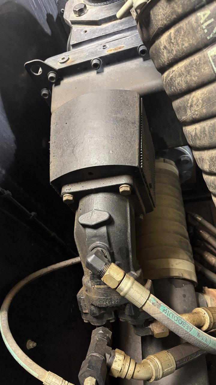

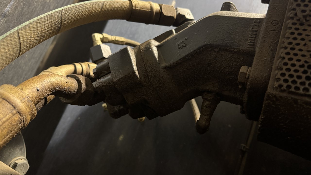

    Here’s a few pics il get few more

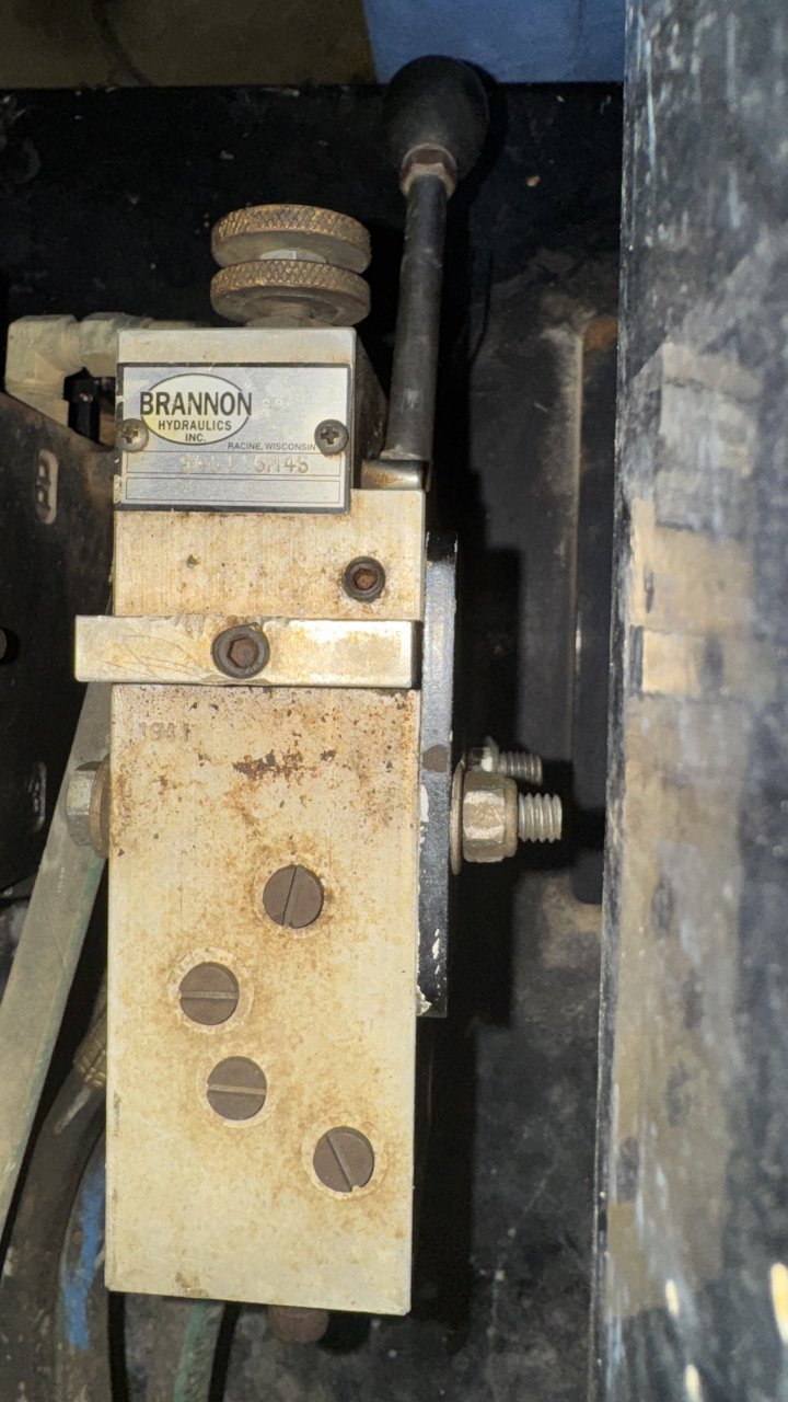

    This is the actuator that activates the blower….. not sure what valve u refer to.. the pump is a Danfoss. All I know is dont have that email from way back when we bought the compensator valve from west tech. With the model and all. The motor is a Roxroth
    Relief pressure settings are manually controlled with the lever operator. Mounting flanges and a lever position lock are also include
