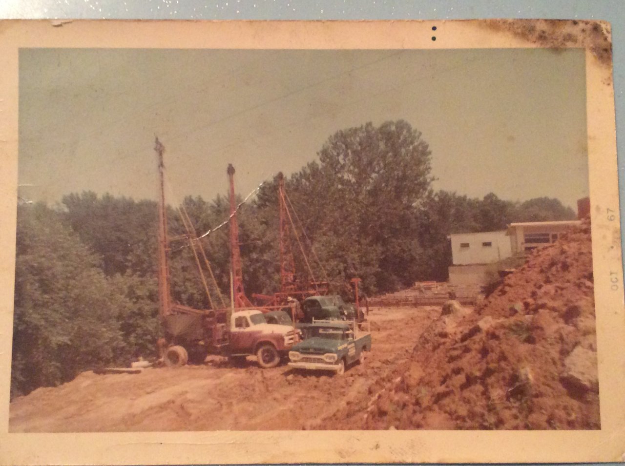

    Before we used winches, all we had was Catheads on the drilling rigs. 1st mechanical winch we had was on. 1961 International B170, had a 21W Bucyrus Erie drilling rig mounted on it. The original means of lifting the Derrick (1piece) was a hand crank unit mounted from the factory in the 40's. My great Uncle mounted a small 12,000 lb winch behind the cab and ran the cable under the machine to the Derrick and double blocked it. Power was a forward / reverse PTO, he also mounted a long handle behind the cab and had a cable running to the clutch arm, it worked flawlessly. Used a lot of hyd winches over the years in drilling, hyd is hard to beat anymore if you get the right setup. But then again, so is mechanical if it's in good working order with a good brake.
