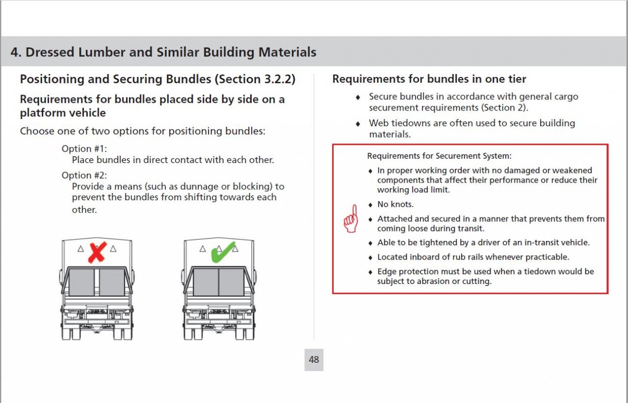

    They're loaded in bundles and there's two layers. They'll try to keep space between each bundle with no blocking. That's illegal. Objects have to be braced/blocked or self braced because when you cinch down your securement it will push the objects toward the center of the trailer and loosen up as you travel.

    there is a couple of ways to load rebar, some like to do two stacks, (on 20ft) front back and one the straddles both, I prefer right down the middle, 3 feet to the rear of center helps with the trailer not bouncing. Assuming you have a spread axle trailer.
    All I did was haul steel for the last 3 years here in Utah, in and out of Nucor weekly and Triple S and the Steel West (both are under Triple S steel umbrella) I am curious where in Lehi you are hauling to though, also where this rebar is coming from. I am not aware of a distributor in North Vegas. There is Nucor here in Plymouth, Utah strange they are making this trip might be used or rejected rebar from a project.
    this is a easy run, no tarp I throw 5 chains on 20fts - no scales on the run either. Come from that address I would say they are 20ft. I don't see a crane there, but then again street view shows an empty lot so its not a terribly old operation.
    Housing, I would ask how much because it sounds like a company store kind of thing, you may wants to rough it in the street. Half your money MAY go to accommodations.
