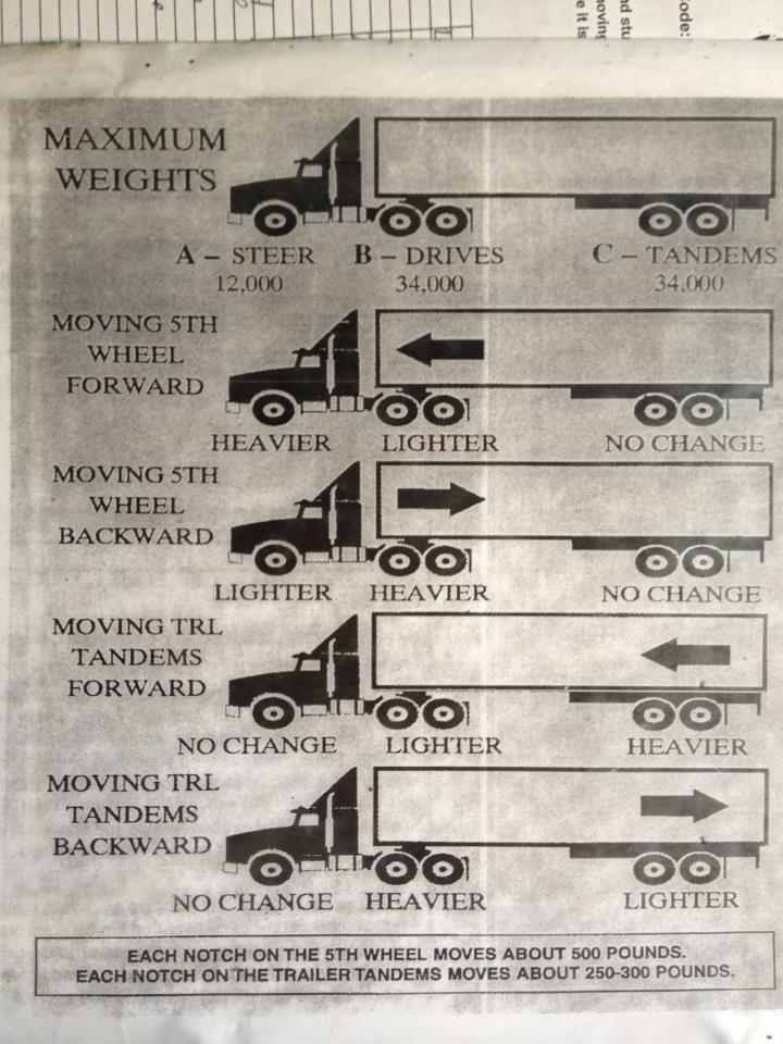

    I tried last night to find the flaw, but the math works, and i agree about what you said. What I think and don't know unless I had the trailer with the numbers he had. What I think is the example has the tandems all the way front, slide 14 back and wallah.

    Considering that the example was off a scale ticket I actually had.. Guess what I did? Slid it 14 holes. Mind you, that trailer was going from IL to IL so I didn't have to worry about bridge law. Final weight was:
    Steers: 10380
    Drives: 33180
    Tandems: 33440

    Actually it would be pretty #### easy to make an app that would tell you how many holes to slide the tandems and in what direction. If you entered the weight that is changed with every hole.
    But it wouldn't work. As some mentioned above, it all depends on how the trailer is loaded. There have been plenty of times when I'm right at 80k with tandems at 43' mark and then there have been plenty of times when same weight scales well with tandems all the way forward. Or any combination in between.
    Just use your head....... The formula I posted is flawed, but it does kind of work every time. It's worked for me every time anyway. Reweigh and adjust accordingly.
