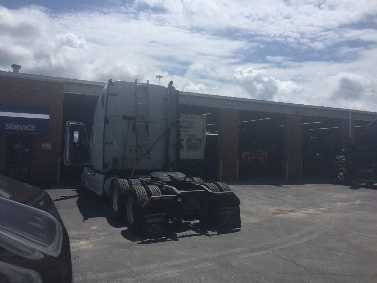

    I bought a 2011 cascadia , on December 2015 , after one months, I thought I was ready to make money , but what was my big surprise, on my first trip to NJ , the check engine light turns on and another check light, so my first trip change direction to the freightliner shop , I spend $1,000 for repair the def , 3 weeks later again the same problem, and again I stop at the freightliner shop , and another $750 , and that's no all for a third time I'm at the freightliner shop for the same problem, I don't know what to do , I can't spend all my money trying to fixed the same problem over and over , does anyone know a good truck shop where they can fix this problem , here in Florida, or GA, NC , SC ,
