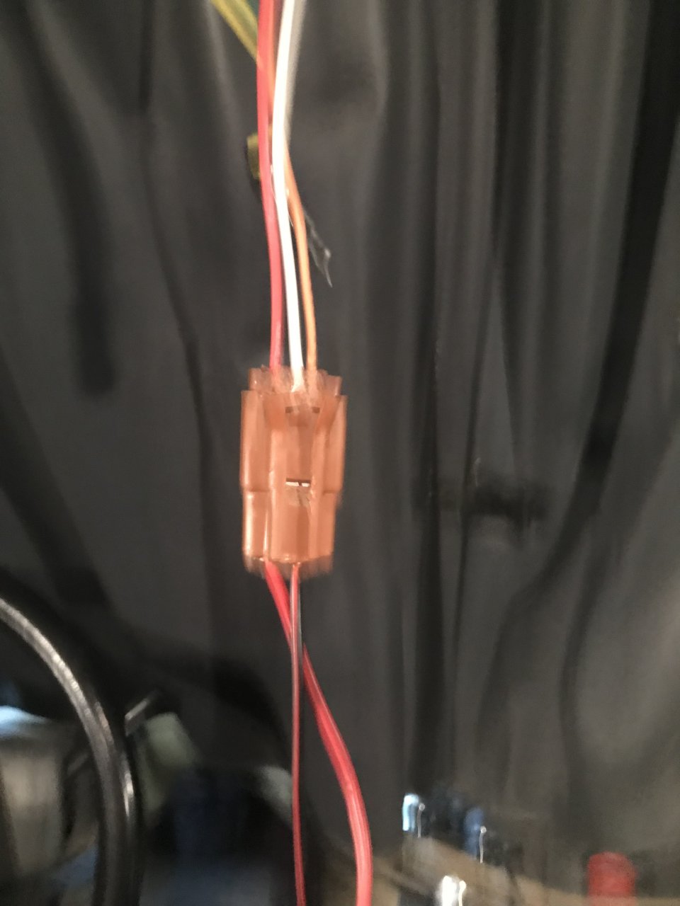

    I pulled it out and found 3 wires. Ground, hot always, and ignition switched. I moved the cb hot wire over to the orange always hot and “problem solved”....Thanks all.

    If your running any kind of power on your radio I would suggest a thicker gauge wire. The wires you found orange/black/red seem to be a carryover from the days when some of the radios had memory options.
