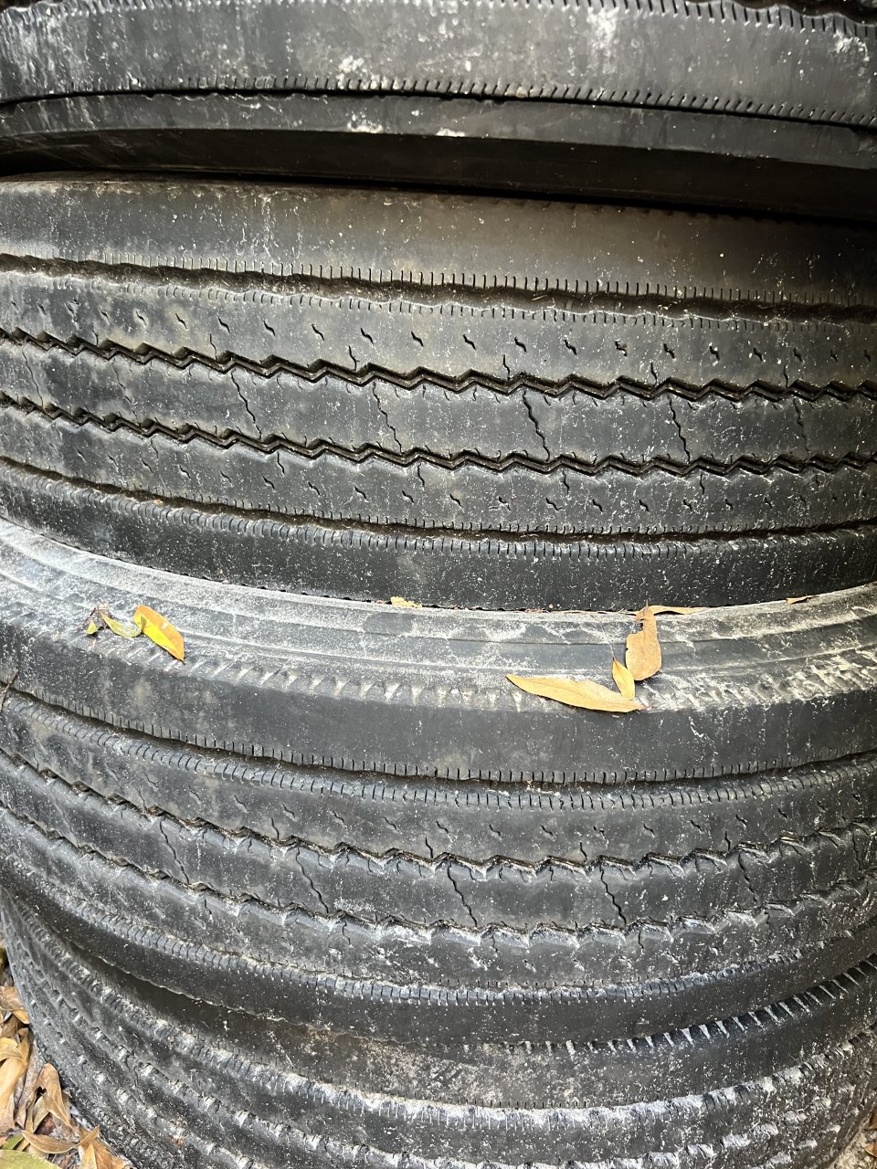

    I try and pull steers before 200k. More like 180k simply because as I’ve mentioned before, the entire truck is depending on those two front tires and they take most of the direct hits with these nice roads
    Here are 3 trailer and two steers I pulled off
    All have the same tread and pretty close to same wear
    Need 3 more and I’ll have a trailer set

  10. GYPSY65
    GYPSY65 Road Train Member
    1,958
    5,266
    Nov 16, 2012
    SW FLA
    Just curious
    What brand are you buying?
    And why are they wearing or how?
    Any pics?
    I do an alignment every 6 months or earlier if a lot of garbage roads and new shocks every 75k and when tires replaced
    Rideandrepair and D.Tibbitt Thank this.
