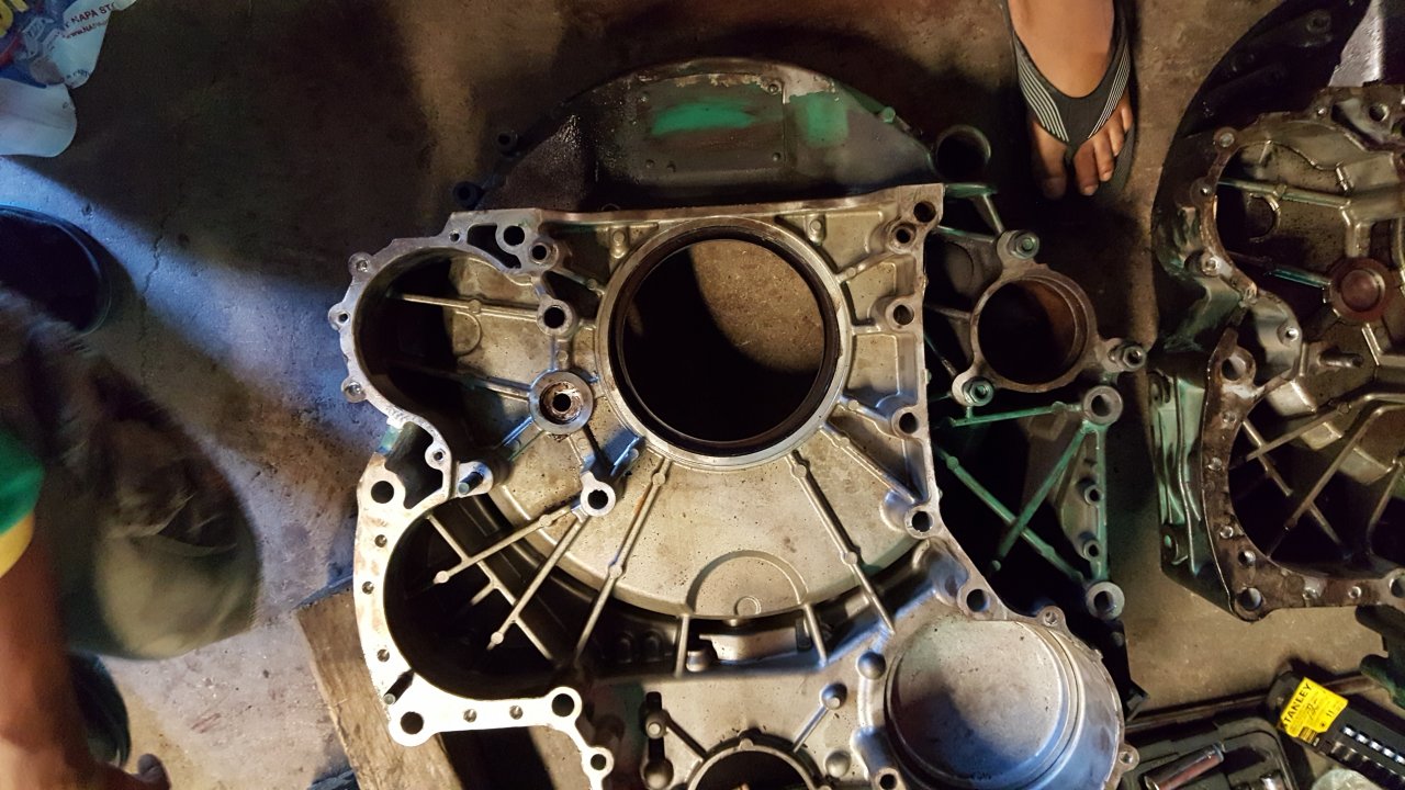

For now we ended up putting a push start button, thanks for the info. Truck is driving and shifting fine taking to dealer for ECU reprogramming tomorrow, posting some ruff pix just now,will post more when we tidy up everythingKB3MMX Thanks this.
attached are some random pix of iShift transmission removal and installing a manual trans. My out of pockets costs were about $3k becoz l had a donor transmission and clutch
. Real Cost parts and labor $5000-$6000 shop rate variable on your location...Will post more pix later

more pix, many thanks to all those who helped read and or commented espcially Benrab...
