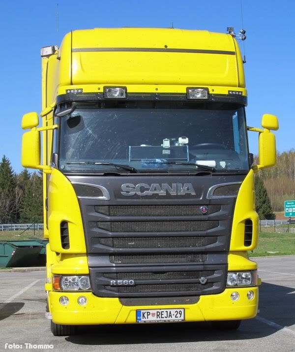

    hey 98989 are those slovenians yellow trucks and trailer don't remember co name still on the bussiness....are they keping up with it...i'd admired them then how clean nice looking were all the time...large scanias 144L 530hp:biggrin_2556:
  10. 98989
    98989 Road Train Member
    5,990
    6,740
    Sep 14, 2008
    reja , yes they still drive both father and son , but they are no longer fast as before after many crashes and violating all speed and hour limits they get on black lists in all countries
    they run now nice fleet of r560 and mirofret reffer trailers with curtain on left
    borrowed images of member from my forum
