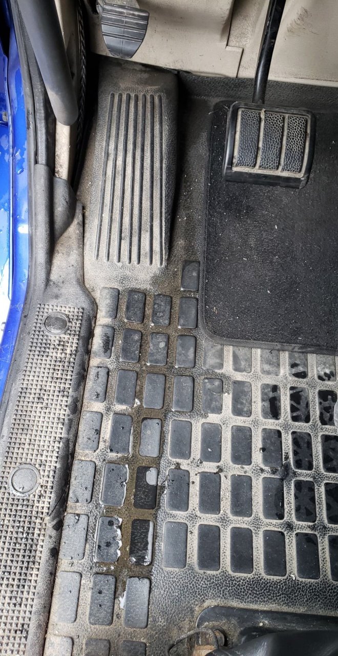

    Not sure where it is coming from. Only happens when I am sitting still.

    Heater core line maybe?
    Did you touch it and smell it?

    Its on the driver side and it is rain water. Been raining all night up here in Connecticut.

    Oh.
    Most likely windsheild.

    Yeah thinking the same. Gonna go to Safelite next week back home and get it pulled and sealing surfaces cleaned

    If Freightliner check around cab marker lights

    Also any grommets for wires to mirror / cb

    All good advice from posts. Were you sitting level, or in a sort of twist on uneven ground? Cabs flex and mayby opened up a seam somewhere. I think volvo has some steel panels on their cabs? Mayby small rust hole or crack. Tube of silicon may be your friend.
