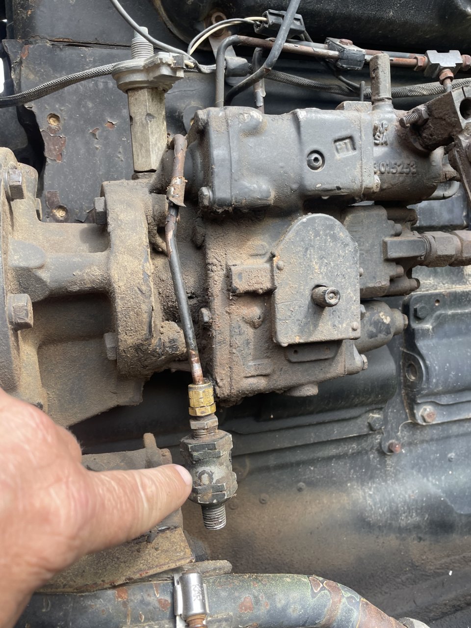

    This is on a Steiger tractor of mine, that has a BC2 310hp engine. What is this item, at the end of the line and what does it do? IMG_6599.jpeg

    It drips diesel very slowly when running but as soon as engine is shut of it drips quite abit, for about a minute.

    My guess is that it’s some kind of check valve. My other question is, none of my other engines, with PT pump, have this. Is it needed for this particular pump?

    That is a check valve, seen many of them on the old 2 stroke Detroits. Not sure what the line is for or where it is attached though….

    Can you post a picture of where it connects to the pump?

    Looks like it's connected to the AFC signal line?

    I was told it is a check valve and it originally should go back to the tank. Here’s the tractor it’s on. IMG_1144.jpeg
