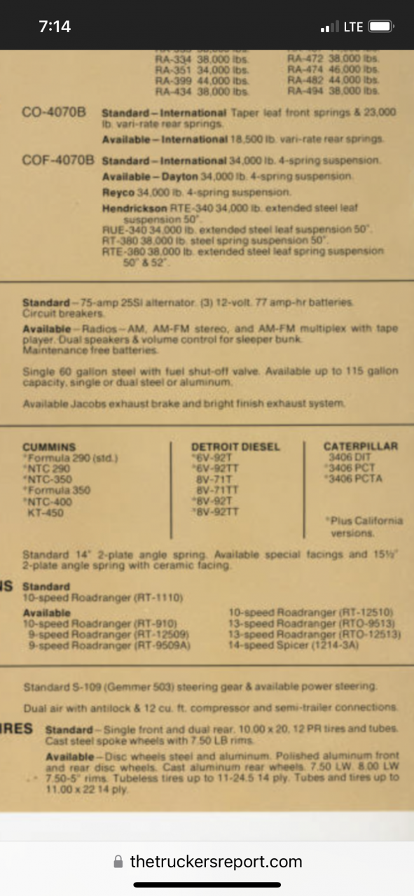

    Here’s the available engine, clutch and transmission options in an ‘81 4070B. 4107C924-7B9F-4A2F-A1CF-0BB5BDF3ABEC.png

    Dec 4, 2019
    I see a 14 speed spicer is available. 2 sticks??
    Jubal Early Times Thanks this.
  7. SmallPackage
    5,945
    19,134
    Dec 20, 2019
    Marion Texas
    No. Air shifted married boxes. Single stick with a dial style knob. Pos. They had 16 and 20 speeds as well. Their answer to RoadRangers. They tried for awhile but they were a pain and lots of problems.
    Uncle had ordered the 16 speed new in a ‘70 351 behind an NTC335. He swapped it out to a RTO12513 within a year or two.
