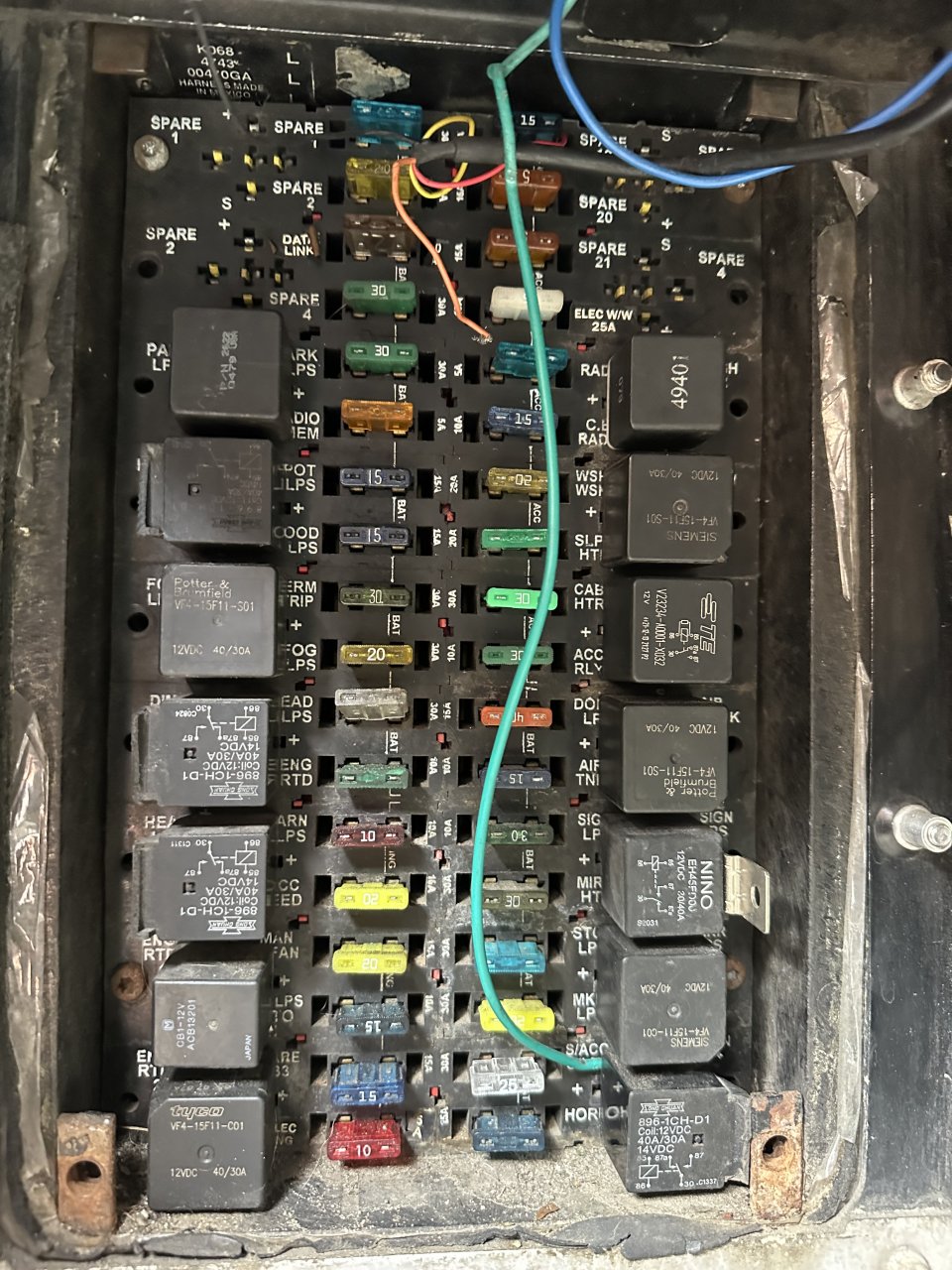

    IMG_9836.jpeg I’m going to check into that. Would anyone happen to know where is the one on t600 your instrument cluster light fuse
