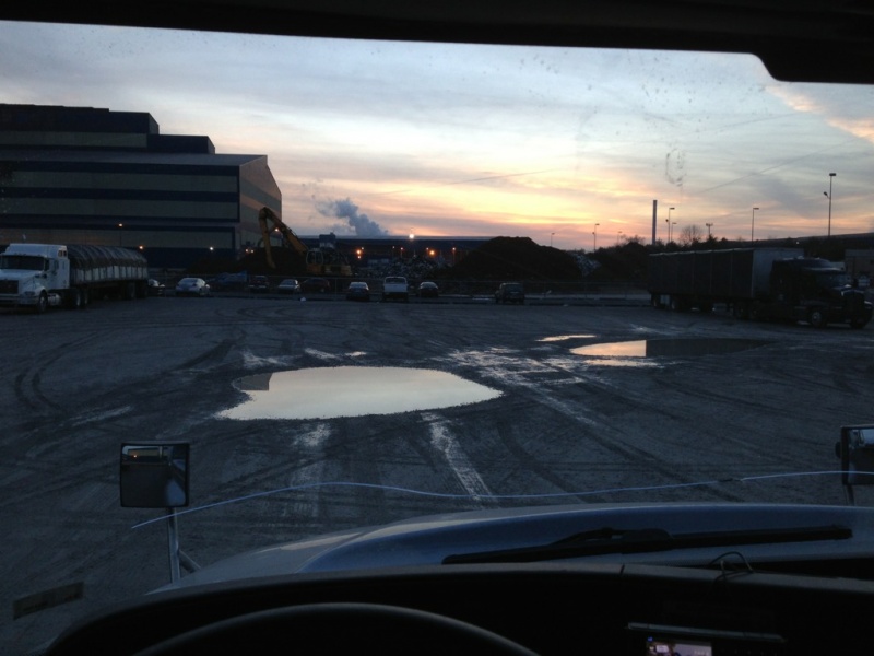

    Alright thanks. I've gone through 3 scale houses and never said a word.
    I'm just waiting to get to a terminal to get it replaced

    If its below the steering wheel it's legal.

    The idea with the paper is that's the "critical" area on the windshield.
    That area CANNOT have any cracks or chips in it.
    If it does, you must replace the windshield. Your not supposed to even do a repair in that space.

    #3 covers cracks and chips.
    And it has three exceptions.
    So if it's a single crack you are good. If there are two or more cracks touching each other than you are no good. Such as it spidering out.
    You can always put a bigger steering wheel in there, lol. :)
    The rest of that regulation is devices and stickers which is the line of sight deal outside the wiper area.

    No spidering. Just one wide crack

    You're good or the crack is!

    Is that crack the real deal?
