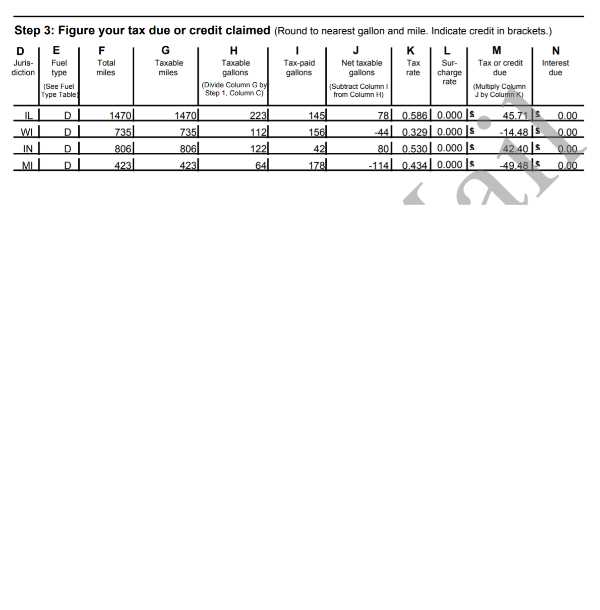

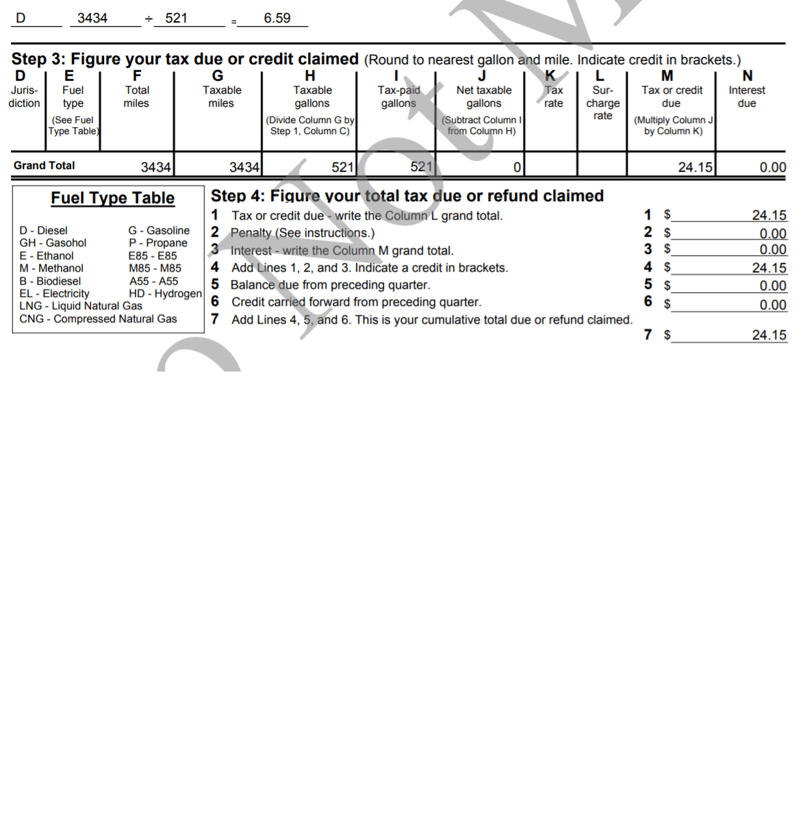

    i think i figured it out thanks your guidance. I did not put how many gallons I bought in each state. that's column "I". so now once I looked at my receipts and put how many gallons I bought in each state, the form looks like that - attached files. it is more comparable to how much someone pays who makes 25k miles a quarter ...thnx

    Still trying to figure out how you did 25,000 miles in a quarter on 2,000 gallons of fuel. That's 12.5 miles per gallon, and IFTA will flag you if you turn in a report with that high of a mpg. My first couple of IFTA reports I had 7.8 mpg and their system flagged me and required me to call their service center before I could continue. I guess they hadn't taken into account the newer fuel efficient trucks, but 12.5 mpg is too high.

    Much better, and realistic for the small numbers
