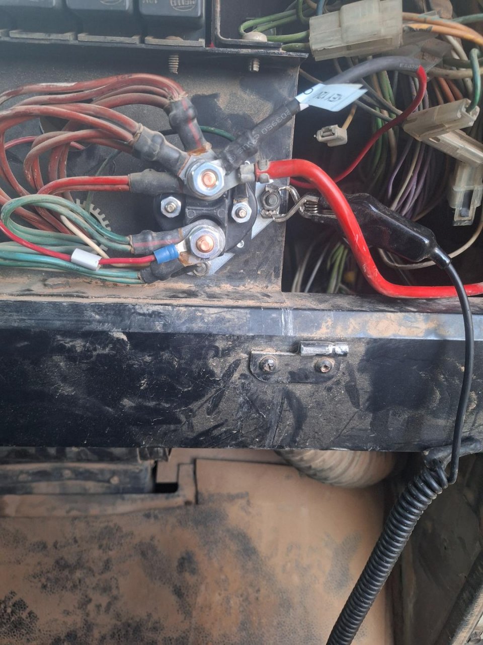

  7. kev2809
    kev2809 Light Load Member
    220
    56
    Jul 2, 2015
    heres a picture, the small stud on the right side has a small green wire, thats where it was on the old solenoid so i put it back. the ground wire is a small white wire that is grounded in between the dash and case..bottom left side.

  8. Heavyd
    Heavyd Road Train Member
    7,830
    6,282
    Feb 4, 2009
    Ok, this big relay on the inside, is this the one you are messing with? This is the accessory feed relay. The one that cranks your engine is on the outside of the firewall, under the hood.

  9. kev2809
    220
    56
    Jul 2, 2015
    yes, this is the one that has been failing though causing all my 12 volt key on stuff not to work. the one on the firewall might be my reason why the truck won't crank without the toggle..I'll check that one tomorrow
  10. Inderjit
    Inderjit Heavy Load Member
    774
    740
    Sep 17, 2017
    The relay on the inside is a continuous duty if you replace it with an intermittent
    duty one it will fail fairly soon. Might be the problem.
  11. kev2809
    220
    56
    Jul 2, 2015
    ya, I think we were talking about 2 different solenoids the entire time...I've been talking about my solenoid inside the cab behind the dash. I just went back and read your post and totally missed you mentioned the one under the hood on the firewall. I'm heading out to test that one now, meanwhile I need to put the continuous duty back behind the dash. so I'm guessing this intermittent duty one would be ok to use on the one under the hood?
